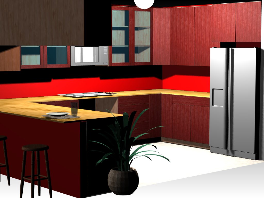

Can someone help me with placing under cabinet lighting so it will show in the render mode.
Still working on this one
greg kitchen1.jpg (94.16 KiB) Viewed 2777 times

Chris, take your rendering and go to DETAIL ROOM, Place some lights in the room. Click onto the light to turn it green, then associate the light to the wall you want. After you have associated the light to the wall, you can dbl click on the wall and move the elevation of the light down so it will be tucked under the cabinet. Return to detail room and then slide the light under the cabinet. At this point go to custom layout and click the presentation view. Wait for the new rendering to show up. At this point you will need to adjust the light intensity. You can move your mouse over the light that is too bright or dim which ever the case may be and while you have your curser over the light, RT CLICK and you should see adjust light intensity, slide you curser down to \"adjust light intensity\" and you will see different levels of intensity. Make your adjustment and re-apply the settings and you should see a difference in the lighting. After you get the lighting adjusted the way you want them, rt click and hide the lighting so you do not see the light fixtures.
Hope this helps
Damon Nabors
