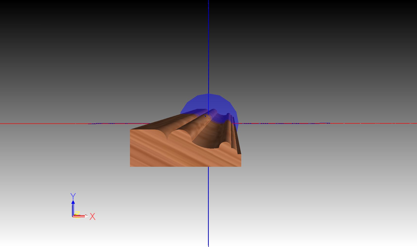

I am try to produce arched casings or straight casings for that matter using e cab can you reproduce any profile?I am attaching a profile that I am working on right. I\"m not sure that e cab has the ability to reproduce any custom profile I,m also not sure if these attachments will view

Will, If you go into the SHAPE MANAGER,you can design any profile tool you want. It takes a little practice but you will be surprised at all the cool stuff you can do with shape manager. After you design your tooling the profile modeler should be able to cut out the molding on the router without the need for custom tooling.

Will,
You first have to create a tool from your jpg. Just like creating a custom molder knife and then you can create any custom molding you want. Straight or curved. I sketch out a profile of a molding I am copying and get the measurements and radii and then use these to create a tool.

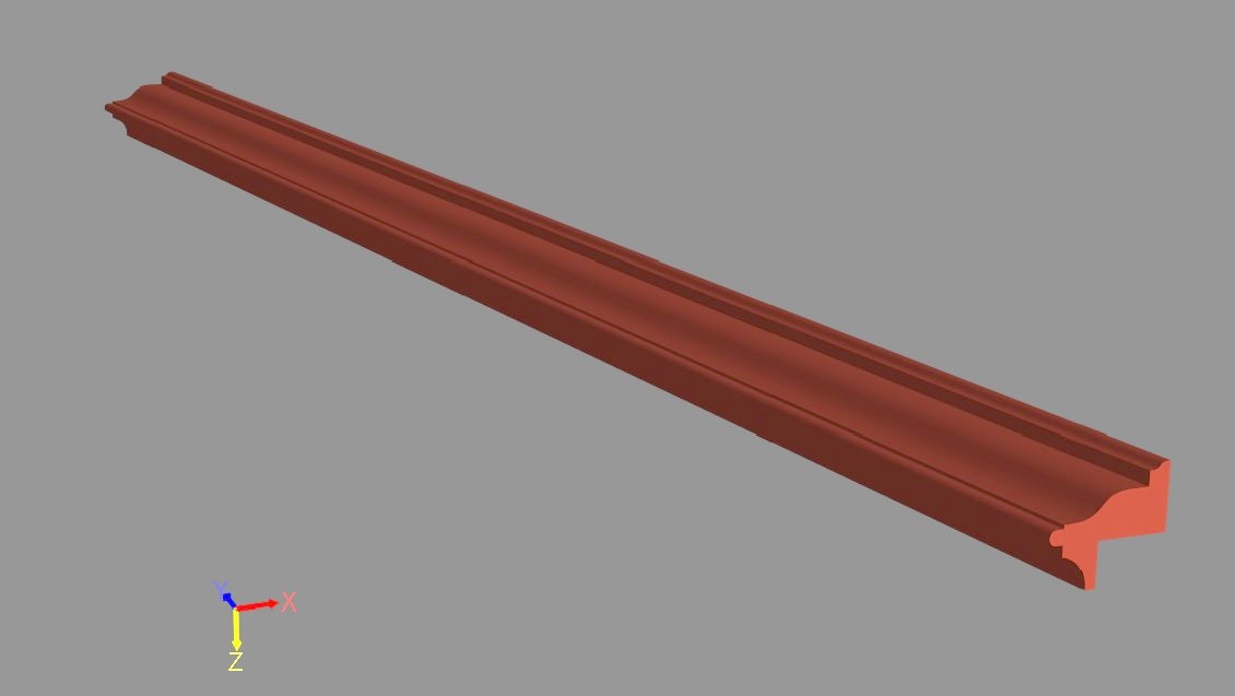

Will, I think this is close to what you are looking for.
base cap.jpg (65.06 KiB) Viewed 6458 times

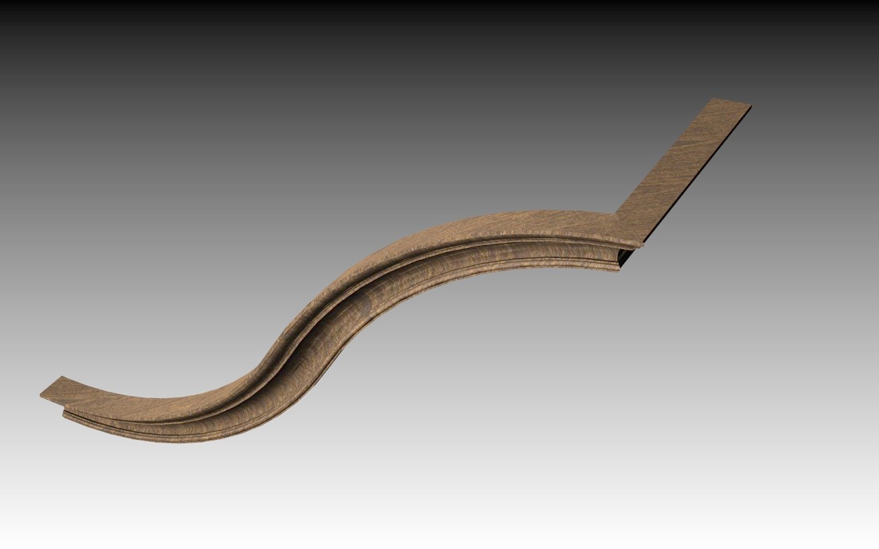

That is close and I have made progress since the post started. Justin is looking at my files right now
Are you using e cacinets only to produce these designs ?

Will,
Yes everything is created in eCabinets.
