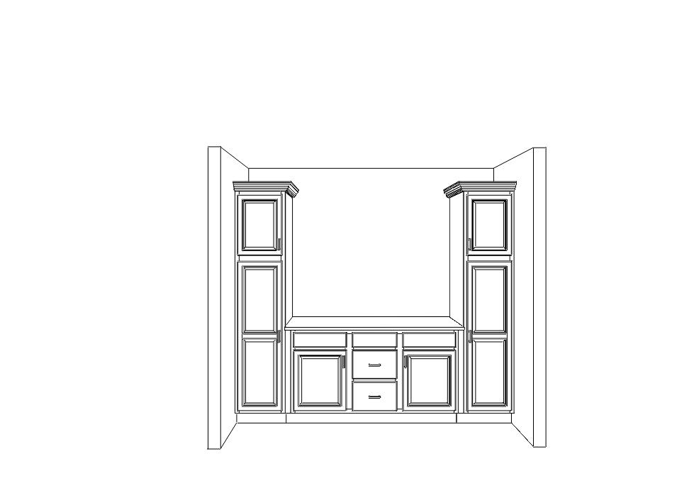

Does e-cab offer a hidden line view of a layout similar to that of 20/20. The wire frame view don't cut it, too many lines and the archirects are lost trying to understand it. Is there a way to hide some of the lines in wireframe?

Why not use the Line Drawing Editor to produce drawings for architects?

Can the whole kitchen, with tops and the works be taken into that. Here is an example of what i am asking.

From the detail or custom view right click take custom layout. Make sure the counter tops are associated to the appropriate walls first. Otherwise they will not show up.
