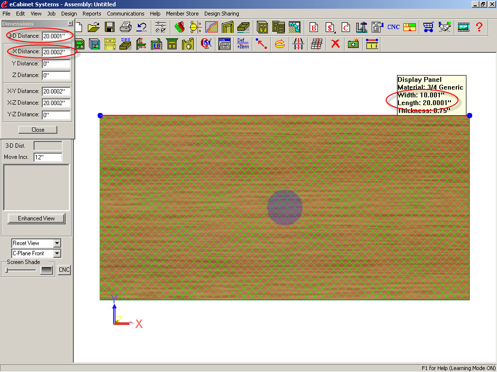

To add to what Rob says...everything is stored internally as decimal 1/1000ths (computers can't do fractions, just decimals :wink: ) but when calculations are done I think the rounding is carried out based on the dimension display setting. If you are using fractions, everything except fit and clearance is rounded to the nearest 1/32\". If you are using decimals, the exact dimensions you enter are maintained.
If you enter a 1/10000\" dimension, there is some funky rounding going on. For example, I created a display panel 10.001\" x 20.0001\". It displays the measurements correctly on the popup but the measuring tool shows the 20.0001\" dimension as 20.0002\".
Of course I don't work in .0001 tolerances so that doesn't bother me. :lol:
