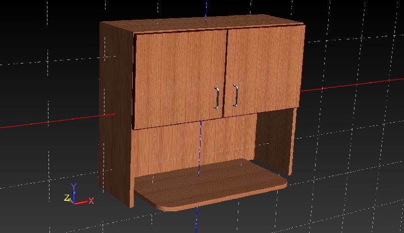

The attached microwave cabinet I made has a display panel for a floor and when I resize the cabinet it won't grow with the cabinet, is this normal? Also I
can't get blind dados to work with the same part. Using a display panel was the only way I could get the floor to be 16\" deep while the rest of the cabinet was 12\" deep.

Display panels cannot be resized. You can use a 4\" negative front inset on the deck to make it 16\" deep in a 12\" deep cabinet.

Thanks Dan, that did the trick! We're going to Dale Nov 12-16 for software class maybe Ill pick up some tricks I can share!! Our new router should be here for Christmas can't wait to start cutting...
