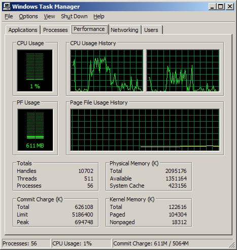

DanEpps wrote:Second, what does memory usage for the eCabinets process look like when it is just sitting there?...
I have attached the image, showing memory use, Dan.

This looks quite normal to me...
