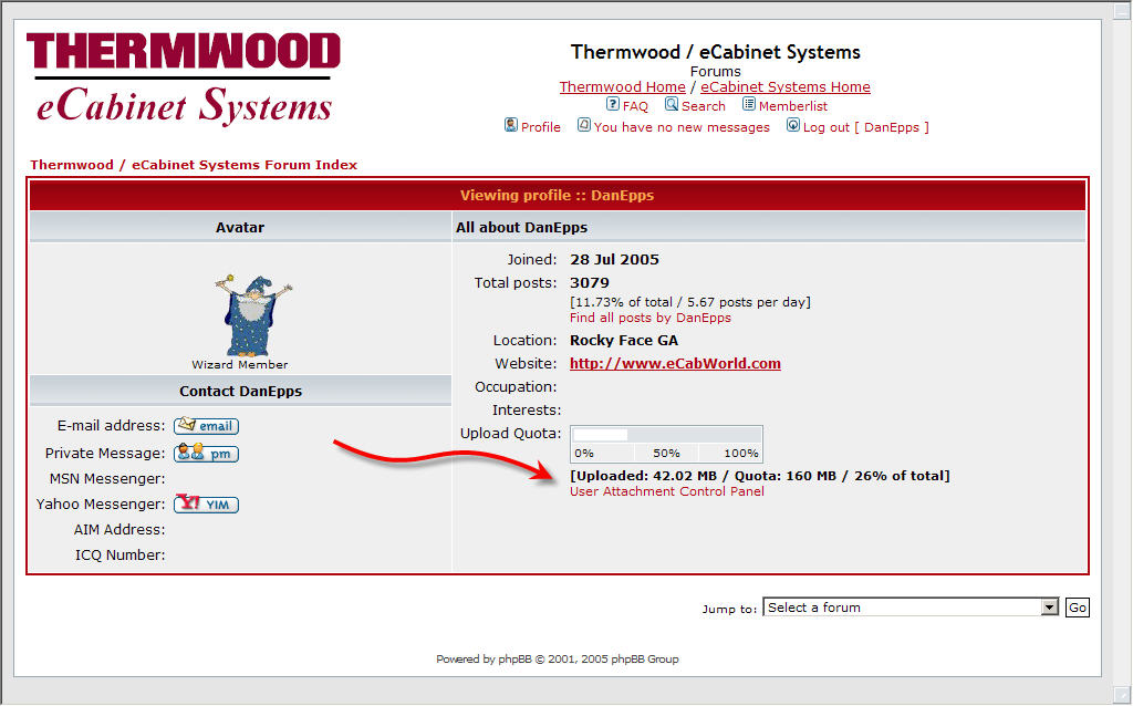

I've E-mailed the file but I cannot find a \"user attachment control panel \" in my Profile. Should I go and delete them by editing the posts? I read that in the FAQ ... Thanks

Rob, click on your name on the forum index page, the control is on the bottom right. Joe
Like this...
User Control Panel.jpg (122.77 KiB) Viewed 10261 times
