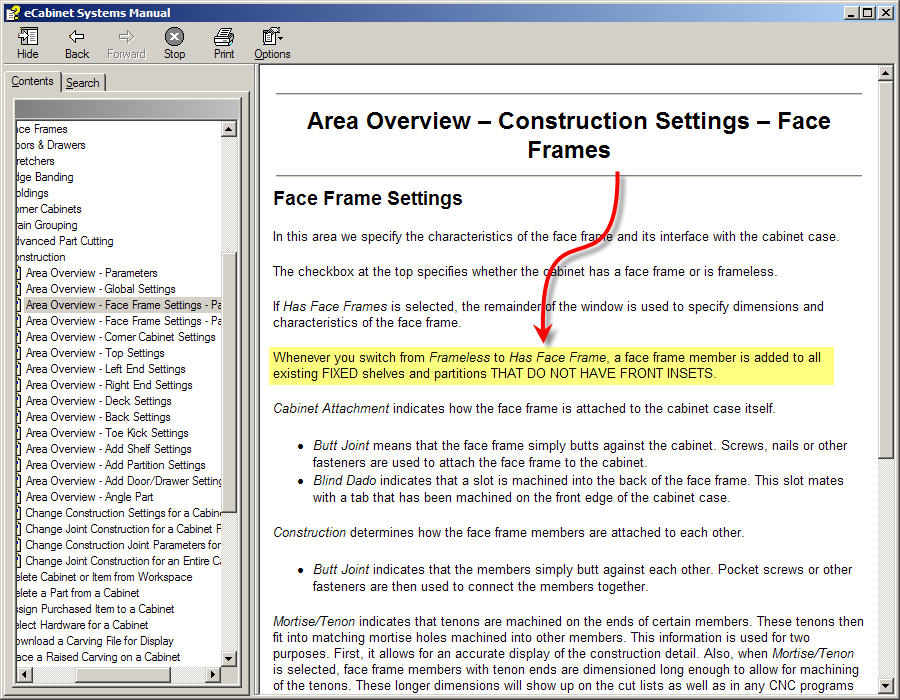

Didn't a previous version automatically add face frame components when a fixed shelf existed before you added face frames? It doesn't do that now but I seem to remember that happening in the past.

Lamar Horton wrote:If it did it was before my time, why was it removed? I started in V4
I started with v4 also...my memory is probably wrong. :lol:
Okay, even though my memory fails me at times (a lot of times), I knew I had used this feature before.
In fact, the current version Help Manual (from the help menu) clearly states what I thought I remembered. The questions is, where did this feature go? I know I have used it before but it doesn't work now.

No it doesn't. I just tried it on a frameless cabinet from the standard cabinet directory.
No, it doesn't work now. It used to and eCabinet Systems Made Easy says it does, but it doesn't.
