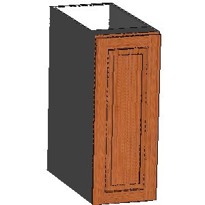

Here's the door, now the height is 775-10 = 763mm :)

Stefan, I dont build frameless so Im not sure about some of the settings but check the size of the sides. I changed the toe kick to 0\" and got the correct size door. Joe
©_std_base_1-door_left_255 no toe.jpg (11.72 KiB) Viewed 14558 times

Joe Soto wrote:Stefan, I dont build frameless so Im not sure about some of the settings but check the size of the sides. I changed the toe kick to 0" and got the correct size door. Joe
I think Joe found the source of your problem. If you're going "toeless", you have to set toe height and inset to 0 in addition to unchecking "Has Toe."

I tried it with my cabinet, didn't work. Downloaded Joe's, did work.
However I do want a footkick to display in my room layouts, so I think I can not just say detached footkick and put the value a zero or my base cabinets will be flat on the floor (I think). I then tried to put the detached footkick value at 100, (initially 102) and the height of my door became 665! Great!
I must say I do not yet understand what setting is influencing this overall restriction. Either way, detached at 102 or 100, my cabinet stays 775 and I figure my door should stay 665. I know I've got a lot to learn and it's the hardest at startup. For now I'm happy I get the correct height. Just wish I understood why :)

Okay, if you have a value in height and have \"Detached Toe\" checked, the actual cabinet height is the defined cabinet height minus the toe height thus, the openings for doors will change accordingly.
For example, if your defined cabinet height is 775mm and you have a 127mm detached toe, the actual cabinet height is 648mm (775-127).
Now, to get the maximum height for an inset door, subtract the thickness of the top and deck from that number. For an overlay door the maximum height is the same as the actual cabinet height.
