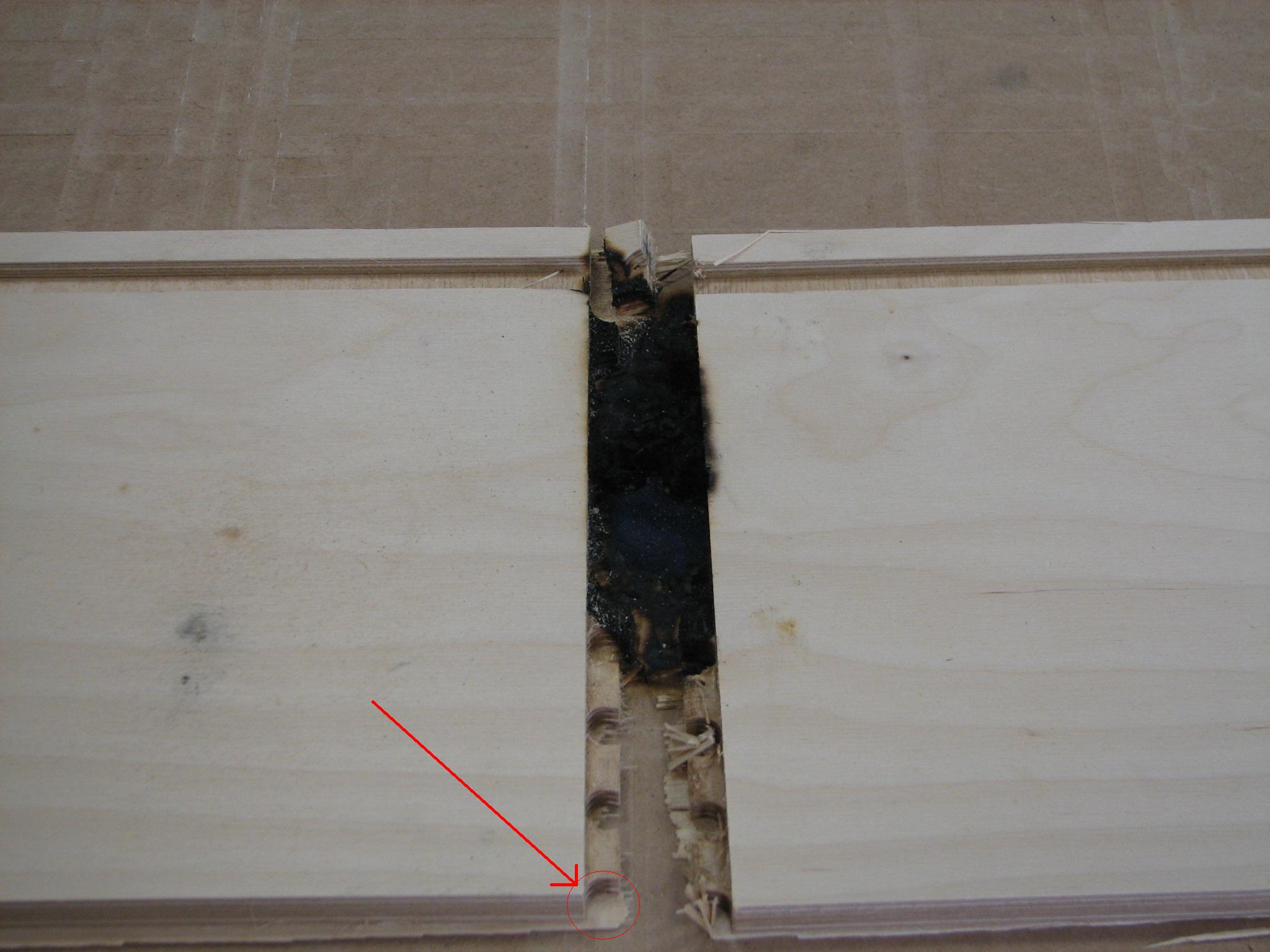

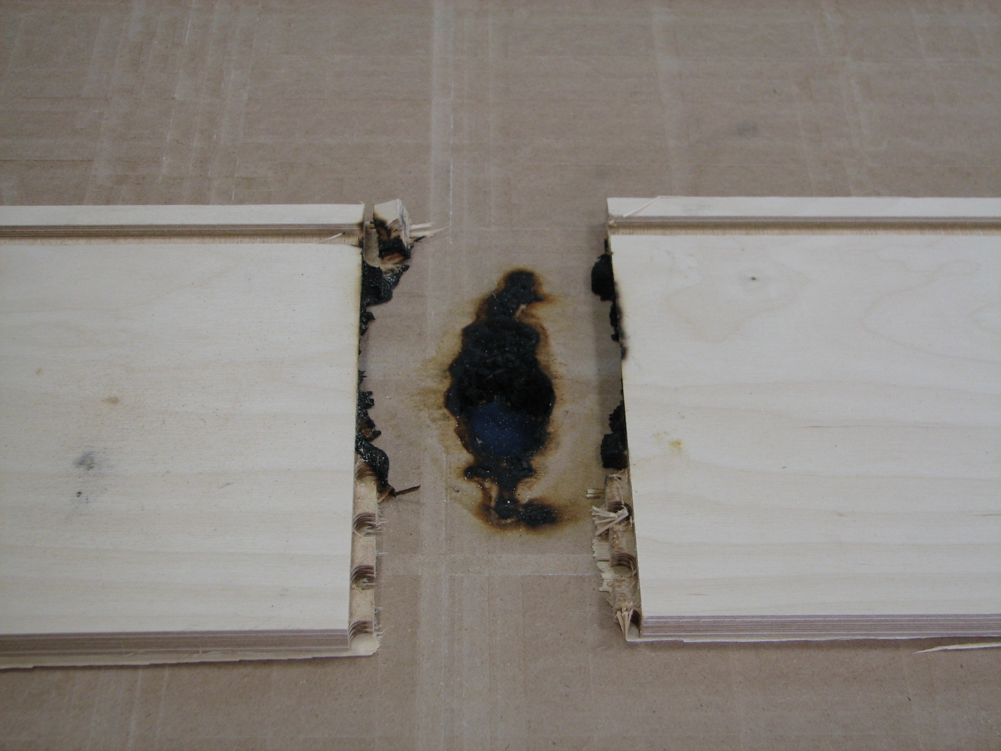

Hey everyone,
I read a lot of other forums and I hear about these guys who start there routers and go home or go to dinner, whatever. Today my operator started a full 48 x 96 sheet of 5/8 baltic birch drawer parts. Knowing that it would take 30 to 45 minutes he went to the edgebander 50' away and had his back to the router for quite a while, mostly just listening to it.Well, he never heard anything different than usual, but he did smell something. To any one who leaves there router running unattended, please look at this picture, and this was after the mess was cleaned up, Burnt through the waste board, through the spoilboard and stained the aluminum table. We really dont know what happened, no tools were broken, none were really burnt, although a 3/8 compression looked like it had got a little hot. I can only imagine that there was a piece of metal imbedded in the baltic birch and when the tool hit it it started smoldering and then the vacuum just kept it rolling. When I shut off the vacuum it died out almost imediantly. WE immediantly dumped our dust collection, trash cans after clean up, anyway, I would think twice about getting to far from your machine, it could of been a real bad day in my life and my employees lives.....

Mike you are probably right about the metal in the plywood but something caught my eye in one of the photos. See the small disk of plywood, I could see one of those getting stuck on the bottom of 3/8 bit. At 18000 rpm it wouldn't take long to build up enough heat to start fire. Just something else to think (worry) about. Joe

Actually I think that is the .030 skin that just never got second passed. i did break the sheet apart, clean it up and kind of reconstruct the crime scene a little..
