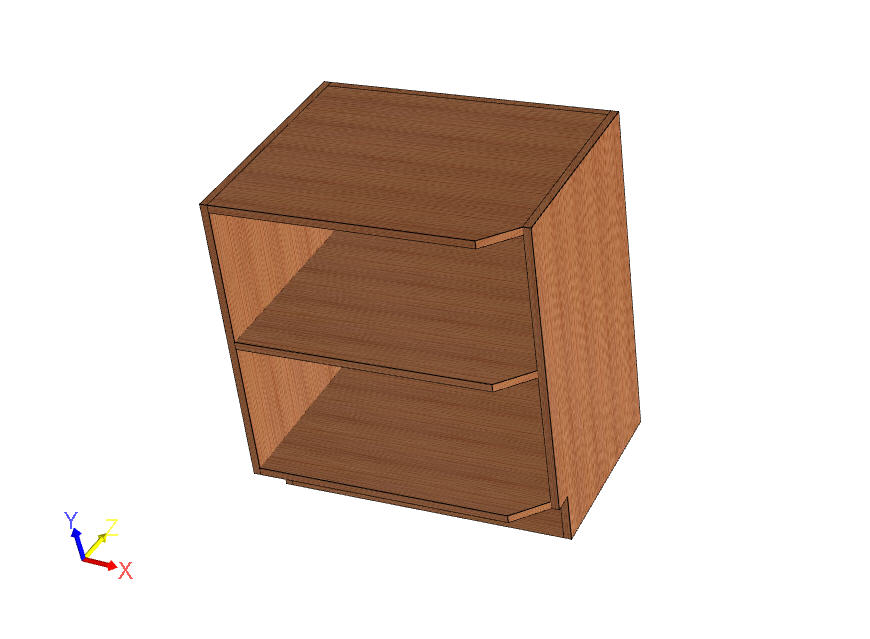

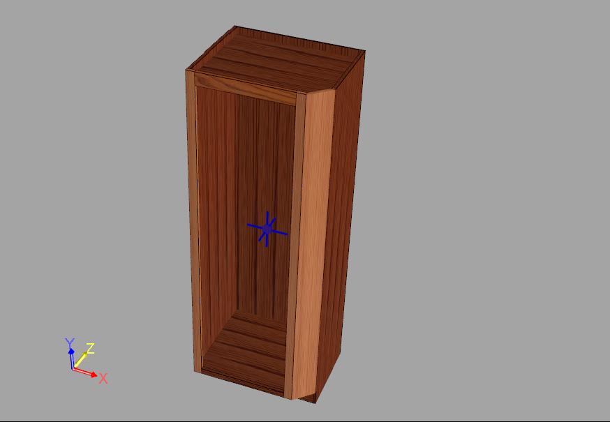

Gene is right...you will have to use the Part Editor to clip the corners on the various parts (top, deck, shelves).
Take one of the parts into the Part Editor. Select the Chamfer tool and at the bottom of the screen, select \"1 Distance\". Enter 3 in the \"Enter Chamfer Distance\" box and press enter.
Now, click on the edge labeled \"Front\" then click on one of the sides (top or bottom in the display)--the right side is at the top of the display.
Do this for all parts that need to be clipped.
Save the cabinet and you can reuse it as a seed when you need a clipped corner cabinet again.
Oh, I forgot...you will also need to set the front inset on the appropriate end to 3\" so it will match the clip.
Here is a picture...
clipped Corner.jpg (47.24 KiB) Viewed 8044 times
Kevin,
You must inset the side of the cabinet and give the face frame a negative scribe value then chamfer the shelves and top and deck as Dan described. Use a display board or panel to complete the corner. You can add flutes etc to this display part.
