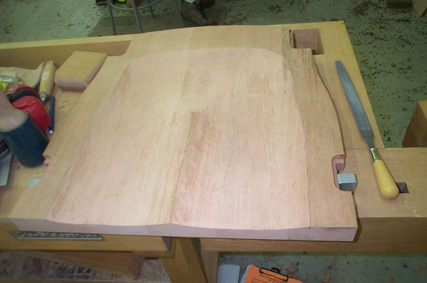

THIS IS ALL I HAVE FOUND
Post by Keith Beggarly »
HERE IS A PIC OF WHAT I FOUND.
hip joint.jpg (62.63 KiB) Viewed 24920 times

Keith Beggarly wrote:HERE IS A PIC OF WHAT I FOUND.
Keith,
THAT looks more like a butt joint to me!!! Thanks - I needed that, for sure... :lol:

I just looked at the video you linked to and I think I understand now.
I think it is when you use criss-crossed stretchers with a keystone in the center. Look at the legs in the table in the video at 2:54. See how the \"stretchers\" come together with the center higher than the ends? If their were a keystone on the center I think this would be a hip joint.

LINK TO EXAMPLE

Gotcha, Keith!
Are the hip joints the INSET four cuts, with the rabbet around them? I was looking at ONLY the carved out portion of the board - sorry!!! :(
NOW it starts to make sense - it is what Dan refered to as the "keystone". Am I starting to get it???
Edit to add: Quoting the next photo:
"The heavily stressed joints like the seat to the legs are hip joints, a special kind of mortise and tenon. The less stressed joints like the arms are dowel joints. We did all the joinery on the chair "square in negative space" while the boards were not shaped. If you look carefully you'll see the arms drawn out and the dowels drilled into the legs. These are ready to be cut on the bandsaw."
That is it! Thanks, Keith. From now on, I promise to LOOK at the images a little longer, AND also to digest them a little better...

Anyway, that joint is not exactly what I was referring to but I see it after Keith's explanation. I too was looking at the carver area on the seat instead of the notched areas for the legs. I think the "hip" must come from the tenon area of the notch.
