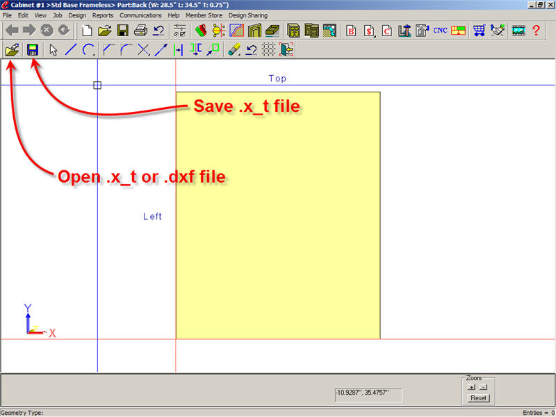

Creating an extended tool file??? Simple!!! In Contour Mode of the Part Editor, after defining but before cutting the holes, click the save (diskette) icon on the bottom toolbar. Browse to your profile tools directory, name the file and save it. Next time you need it, open it (make sure you select .x_t as file type to open) and cut the holes.
Save x_t.jpg (63.62 KiB) Viewed 4809 times
