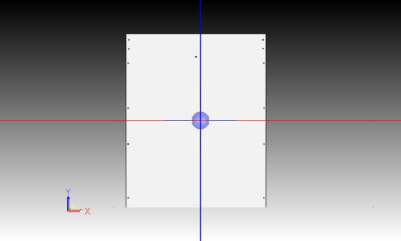

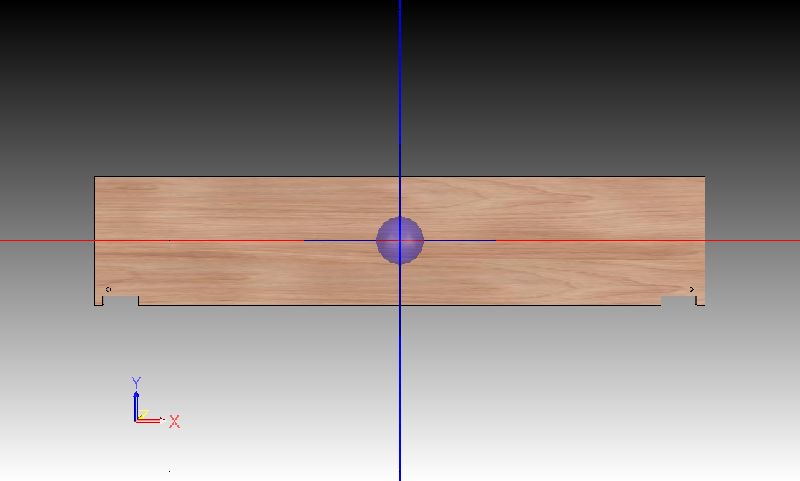

I did make a resizable cabinet piece that I use for the notch and hole. I is time comsuming. Even if it were possible to notch and drill while cutting a dovetail box, the hole would be a flip-op. I have aslo tried cutting a slot in place of the hole and so far, it works. It is just faster and easier than drilling to a certain depth. I also made a resizable part that I use for my Metabox(I use Mepla Alfit). It still needs work because the hole pattern is different with drawer length. I think the Metabox is set-up for system holes but that's too many holes to drill in each part. I'll sent pic's in another reply.

On the Metabox, I edgeband the top then cut to separate the bottom from the back. The through hole in the middle is so I can screw up into the back to support bigger drawers. I still needs work but can be done (as a cabinet, not as a drawer).
