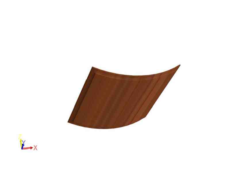

Kerry, could you possibly shed some light on how you made the curved wall. I have tried will little progress. I tried with a large display cube and created a tool to model it out, but it doesn't work very well. Could you possibly give me some pointers to get me going in the right path?

Let me restate my request. I know how to make a curved wall. I would like to know how to make a curved wall so that when it is taken into the parts editor, it is standing upright. I would like to see if I can put a cut pattern on it to look like raised panels, but in a curve. Or so I could make a bow front door on a cabinet.
Damon Nabors
Re: Ruffled Feathers!!!!!!!!!!
You mean like this Damon?
Don't ask how I did it because I don't remember. :oops: It is in an old post somewhere in the forum...I'll see if I can find it.
