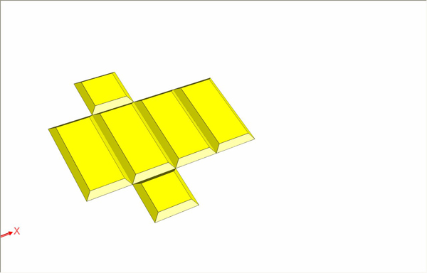

Presently you would have to lay it out in the part editor and then cut it with the profile modeler on the machine.
I actually laid up a box the other night at home for fun to see how it would work...I just don't have any time on the router at the moment to run it and see how it would come out.

Ok question i have about profile modeler is how do i add tooling in such as a standard 1/2" 45degree VGroove bit to give me that appearance when choosing a tool? As tool i have for it don't look like those...Is there more files to download and add for more tooling options???

WE have made several Desks and columns mitre folding with ecabs, our method:
1. Acurately measure the tooling
2.Create tool in shape manager(center on 0,0,0)
3. Load tool specs into tool manager at CN
4. In parts editor offset tool (comp out) amount you are cutting into spoil board(we use 1/32)
5. Make test cut,(use cutom tool for region in profile modeler) or have the tool loaded on the router and cut through CN..
6. measure, adjust from there...
7. load your sheets and go...
The cuts come out great as long as you dig the tip into the spoil board a little, we have also miter folded Solid surface and PLAM using this method

I tried doing this and 1 Problem when i go to nest i get a "ERROR In REGION #2" What am i doing wrong to this??!!?!
Roger Erismann
Posts: 169
Joined: Sun, Dec 04 2005, 11:42PM
Location: Sacramento, CA and Rolla, Mo
Re: Fold together veneer box?
Post by Roger Erismann »
Error in region 2 means that you are not using one tool to make the cut...you need to specify a custom tool in profile modeler....right now it is trying to make the miters using a variety of tools....
If you are using the correct profile there would only be one region in Profile Modeler....
