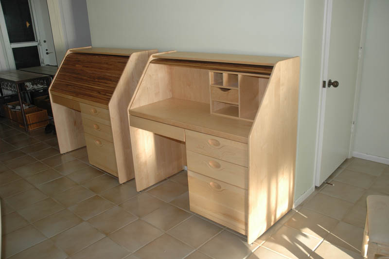

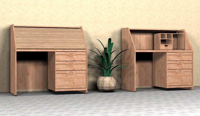

This is a design for a modern roll top desk for lap top computers that I build recently.
It was built out of maple and the roll top itself was done with zebra wood.
Each end was solid maple as they had tracks routed into each for the roll top and I did not want to see plywood ends. The top, desktop, drawer stack and the back was built using 3/4 maple plywood with solid 1/8" wood edging. The back was attached to the left side using dowels prior to finishing. The right side was attached using pocket screws inside the drawer box after it was finished and the roll top inserted. The desk top was attached using pocket screws and the holes were elongated to allow for wood movement of the solid wood ends. The back was finished as well so that it could be viewed from all angles.
Drawer fronts were solid maple with finger pulls and a simple design routed into the front. The drawer fronts were glued up as a single piece and then cut into individual drawer fronts so that the grain would flow from one drawer front to the next. Drawer box were solid maple dovetail with full extention Blum tandom slides. Left hand drawer is a key board drawer where the front folds flat, and flush, with the drawer bottom.
Finish was ML Campbell Krystal in a satin sheen. It was applied using a Kremlin MVX air assist which sprays nicely into the corners. This was important as most of the desk was assembled prior to finishing.
This was a commisioned work that I charged $5,850 for the pair or $2,925 for each desk. I do wish I would have tried harder to convince the client to make the two desk mirror images of each other. This would have made each of the two desk totally unique.

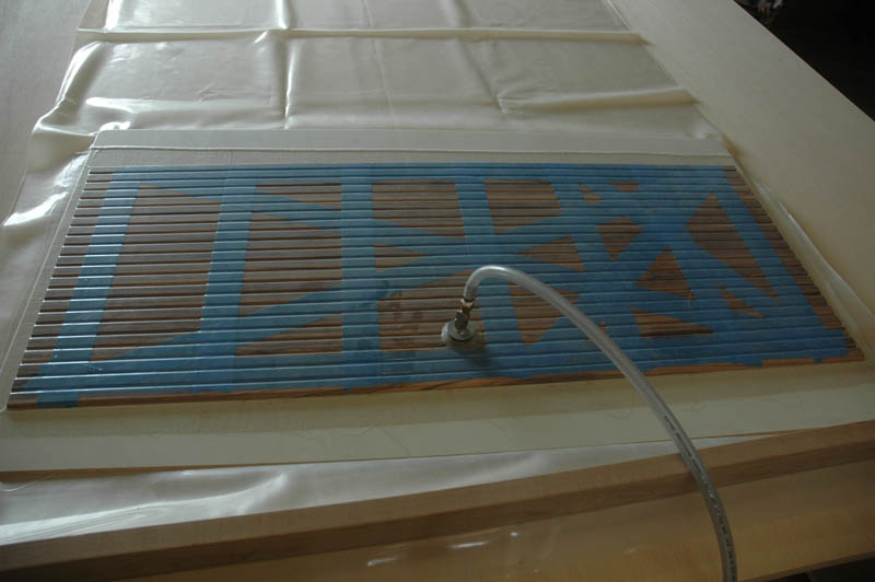

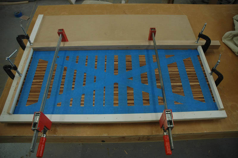

The tambor was simple strips with a simple 45 degree bevel. I used a jig to align and tape the pieces together. It was then glued to canvas drop cloth material using Titebond III and a vacuum press. (See photos)
roll top jig.jpg (87.2 KiB) Viewed 17188 times

Nice design in eCabs and even nicer execution in the shop! Love that MLC Krystal and an AAA pump!
