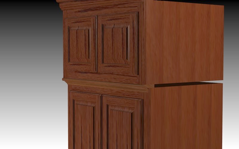

Re: Advice on Tall Cabinetry
Vince,
I too think stacked multiple boxes is the way to go. I use a 4/4 board bull-nosed to separate the boxes to simplify the installation. You can also use it with a small bed or crown molding to step out the upper boxes to break things up a bit.

Vince, we have been doing all tall cabinetry using the stacked boxes method.
Our boxes are always frameless, and our door reveals are 0mm bottoms, 1.5mm sides, and 3mm tops. Paired doors have a 3mm reveal at center meet-up.
Done this way, no intermediate molding is required, as Kerry shows, and the door-to-door margin of stacked cabs is 3mm.

Kerry, we have done it many times. Always frameless.
Stacked tall cabs at 0mm reveal bottom, 3mm reveal top, is the standard of the frameless True32 world, and thousands of them have been done this way. It is fast, easy, and less expensive than using an intermediate part.
Your pics show faceframed cabs. The OP said his arrangement is euro. Translation: frameless.
The pic shows cabs in the background, against the wall, done this way.
