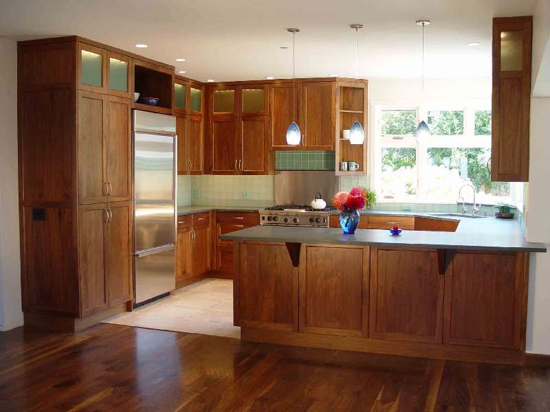

Here is the look I will be doing next week, but all in CVG douglas fir. This is from Chad Reitan's gallery pages on Woodweb.
Gene Davis
Re: Aesthetics in Cabinet Making
Post by Gene Davis »
Notice in this pic, that the large L-bumpout filler with integral leg, is used to make the depth change transition.
Otherwise, cabs are frameless, with no intermediate moldings.

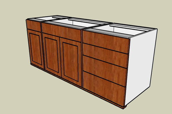

Intermediate spacers, and one across the bottom, can give some detail to a frameless run, as shown in this Sketchup piece. I've not shown an end treatment.

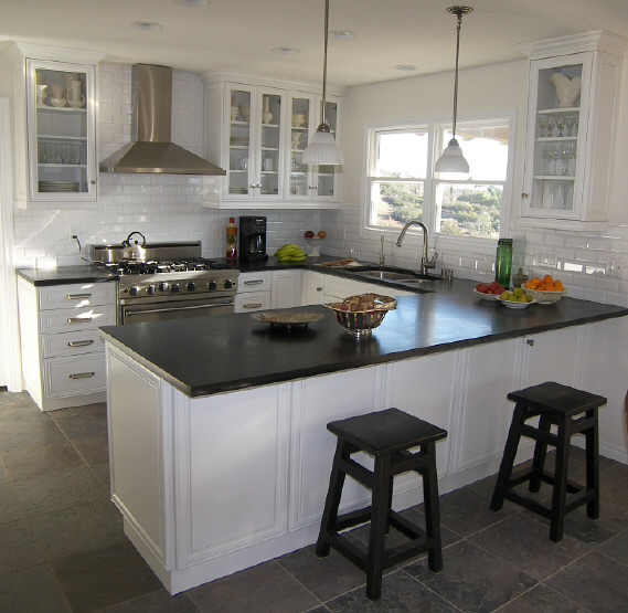

And again, in a version from our friends at Crown Point Cabinetry, over in New Hampshire, I believe.

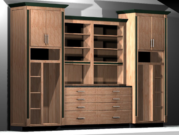

Here's one dressed up a little with wallcab height changes, and some crown. Pretty basic, otherwise, but the client can see what the proposed job will look like. In my area, there is no competition at all that is using any finer renderings than this. Please don't move here, Kerry!
