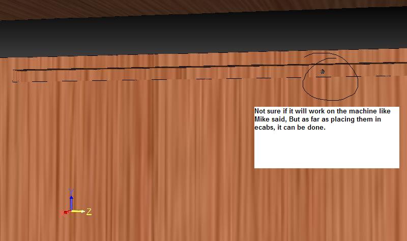

You will have to figure the center of the dado and go into parts editor and place them there.
.125 Hole in Dado.jpg (35.58 KiB) Viewed 23395 times

I have tried this recently and it still gives problems. In my case, I didn't get an error but my 5mm holes were about 3/8" and my dadoes(blind) did not cut at all. I've also had this with full dadoes.

I did manage to get this to work a little while back. Placing the holes in a blind dado with 100% cut was done very easily in the part editor and it didnt come back with any errors for me. Occasionally it came back with an error saying it may effect tenons or something like that but it never actually caused an issue. I did find that if the dado was only 50% that it couldn't find the appropriate tool for an operation which was simply because the edge of the hole was touching the edge of the dado. I offset the hole in the dado and it worked as far as I can remember, this may not work in some cases depending on what guage screws and what thickness materials you are using.
I will be looking further into this in the very near future to get it all working properly. I may decide to just use blind dado and squirt some glue in, then wack a panel pin or something to hold it till the glue goes off. Not too keen on this option but it could work for others.

Hey Guys, I dont have time to try this, but I am thinking that if you put your holes on from the outside, and then leave them just short of going through into the dado you might get it to work. I have used this method in a couple other situations and it worked. Say you have .750 material, a .375 dado and then a .300 hole depth. I am betting this will machine and the .050 skin between the hole and dado should not bother assembly. If it works you could even tune it in to a smaller thickness..

I dont see why that wouldnt work. The only reason I personally didnt try that is because I wanted to save on machine time as much as possible and drilling from the oposite side to the dado would require a flip operation which is what I was trying to avoid.

Thats exactly the same conclusion I came up with :) You can drill through the dado from the same side of the dado with no problems if the dado is 100% thickness. We do this with a few of our cabinets with great success.
