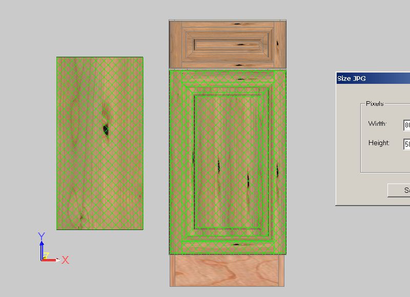

Hello Francis,
If I am understanding you correctly you can acheive this with the match texture button. When you select your Conestoga door and drwer fronts just make sure you select "Purchase Unfinished" if you are purchasing through them.
Than while in the Cabinet Editor LOAD ITEM, DISPLAY CUBES,SELECT IMAGE, ADD IMAGE, Put the image you want to use in a folder ( I created one called MY Wood Pics) than it will always be there for future use. Than go back and define size. Any size will work here so just make it 12 x 12 x 1 , than hit OK. Your display cube image will now likely be inside of the cabinet so right click on the cab door and click visibilty HIDE PART . Than click on your display image ( it should have green cross hash marks on it). While holding the control key and your right mouse button pull the display cube off to the side of the cab.
Next right click on the cab door and click visibilty RESTORE ALL. Right click on the door hit MATCH TEXTURE
than left click on your display cube and the door will match the image. Do the same for your drawer front .
I attached a screen shot doing this with a knotty alder sample.
Hope this helps
Vince
