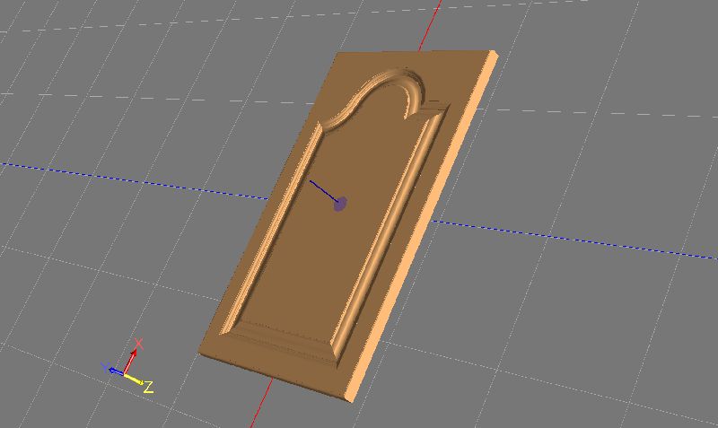

Leigh, you can pull up a display panel of what ever door size you want, then take the panel into the parts editor and create the geometry on the panel and cut it out with a profile tool that you have save or created. It is time consuming, but you can have fun creating new designs.
Here is a crude door example that I just made in a hurry to show you that you can make most any shape.
sample mdf door.jpg (32.39 KiB) Viewed 13205 times

thanks damon i thought this would be the only way of doing it, problem is you cant resize. would you not be able to use a back? i would of liked my doors to come up in the door drawer editor really, so is it not possible to create a door and input in the door drawer editor. because by doing my own door i will have to allign it up myself, this isnt a problem for me but the designer may have a few problems trying to put the door in place all the time. Will it be different on the cut list at all?
Leigh
Re: Doors and drawers
You can resize...IF you use a cabinet part (like a back panel) instead of a display panel and set constraints on the geometry. :wink:

Hi guys i have tried this now, looking at your picture you seem to be fine with it. when i enter the profile tool the corners dont seem to miter together, they are just straight! Is ther a way to miter the corners?
