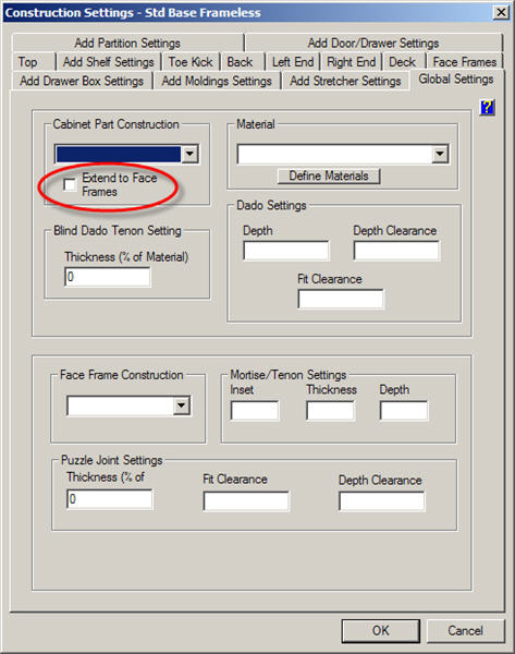

You shouldn't have to change each part to get tenons on the front edges if you change Global Construction to full dado. If you have face frames just check the "Extend to Face Frames" box (see image below) and it will put tenons on the front edges.
Of course this won't help in what you are trying to do Gale. If I understand correctly you are trying to make a completely enclosed cube with full dado construction for all parts. Since you cannot put a solid front on a cabinet except by adding a Display Panel, you will have to manually create the dadoes on the front panel and the tenons on the front edge of the adjoining cabinet parts.

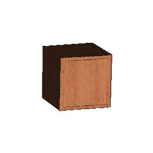

Here is my attempt at the "Six Sided Cube". I closed off the "front opening" with a Stretcher with Blind-Dadoes on all four edges. I then used the Adjust Stretcher feature to lock it to the FRONT and to the SIDES.
Don't forget that now, since it is a six sided box, you can manipulate the other joint/part relationships to get the look that you want and then ANY part could be the "FRONT".
Brad
