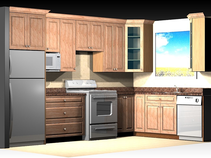

John... You can add all your cabinets to a room and then figure out your lengths and add the crown after. This room was all done after.

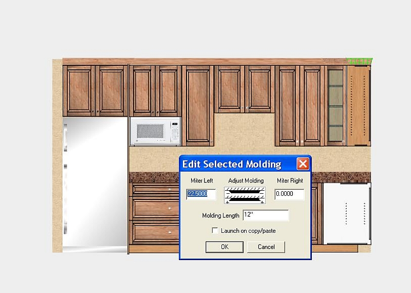

Wally,
When I place the molding the way you say I have problems getting the miter. How do you accomplish this? I could get the correct lenght but the miter would not show. :cry:

John J. Desmond wrote:Wally,
When I place the molding the way you say I have problems getting the miter. How do you accomplish this? I could get the correct length but the miter would not show. :cry:
John D.
John -- You can place 1 piece of mldg. and then copy and paste it again and again. Then you highlight the mldg. and RC and EDIT mldg. where you can set length and angle on ends then Rotate it to where it should be.

Wally,
That did work just fine. It takes awhile but then again I just learned it.
