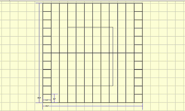

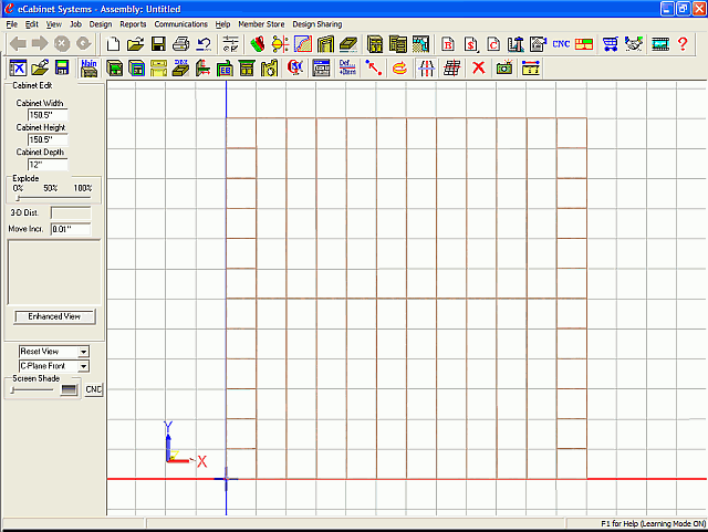

Using a 12" grid, I created a cabinet shape I could scale for reference. (Corner openings are 12" square with 0.5 thick material all around. See attachment square0.gif). Taking this to the LDE, I found that by setting the grid in LDE to 1.47875", I was able to recreate the same "virtual" image, and note that it is (of course) still the same dimensions. (See square1.gif)

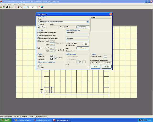

Attachment Square2.gif shows the printing options in Image Control, and with the laser printer that I have, this prints this page with the 8 grid "blocks" every 5 inches, which is 1.6 blocks per inch. If the actual grid blocks are 12 inches at full scale, and the blocks here are 0.625", than my print is scaled 19.2 to 1 (12/0.625) Thus, this print scale is then 0.625 inches = 1 foot. The figures may be different for your application, but the procedure should be the same.

150.5" square, on a 12" grid
Same shape and grid in LDE - 1.47875" grid
Printing options in Image Control.
