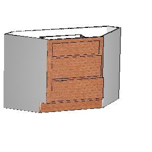

This unit worked fine in 5.1 but now, when I try to change drawers, it gives me a steady increment in the size of the drawer front depending on which one I insert first, second and last. It increases in size in that order. I even tried starting with the middle one and still the same thing.
Can someone make head or tail of this? Could be a bug I guess and will need to be addressed.

The drawer boxes and fronts work ok in there own editor, it's when you take it to main that it all flies apart. :(

I’ve got this listed for the programmers. If you remove the FF and uncheck “left and right sides miter” from the corner settings then reapply your FF the drawers should work.

Well, that fixed the drawer issue but screwed up the back as you can see in the attached image. The left side is now 1/4" wider the the right side. Nothing I seem to be able to do to fix that either.
