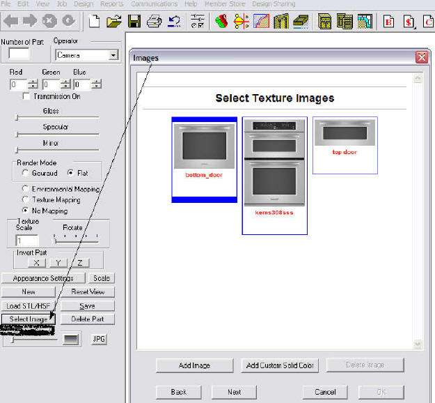

Sergio -- Make a Display cube the size of your double oven and use an image of it that you have saved to your image file. Here is one that I just used.

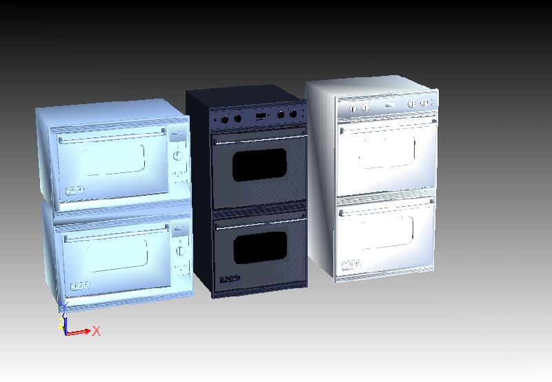

Re: Double oven cabinet
Double ovens
They are Hsf Files
Ranges fit in Cabinets.zip
(86.09 KiB) Downloaded 943 times

Thank you very much George,
I have downloaded them and getting ready to use.

George Davidson wrote:Double ovens
They are Hsf Files
George -- Did you make these or download them? The image I used is the actual oven that my client ordered and I was wondering if they could be made into Hsf files.
I downloaded it here from Customer 3D Files

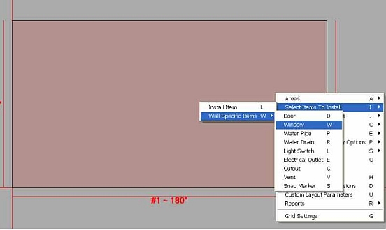

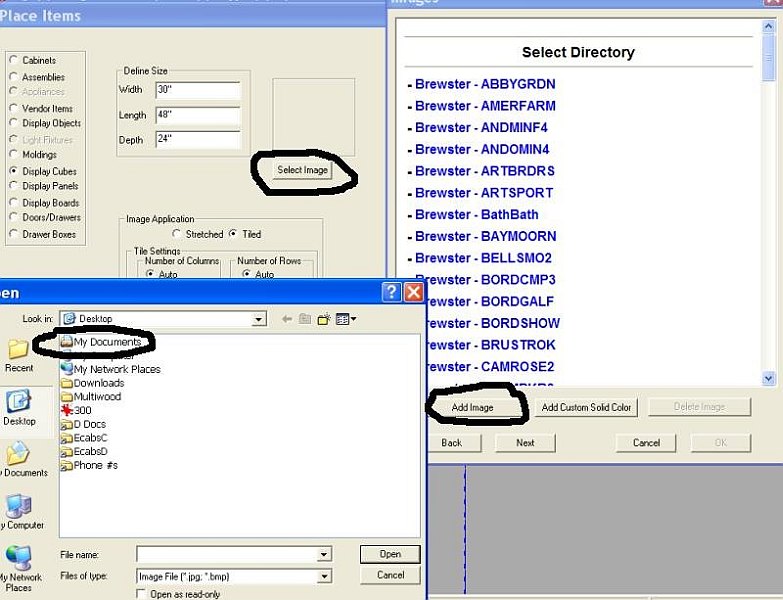

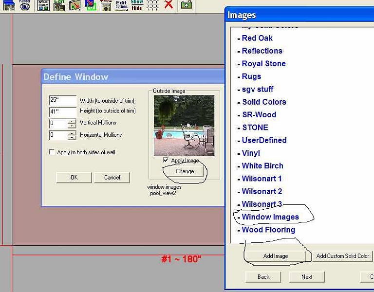

Here's 3 pics. I hope they help. There are also video tutorials in the help section.

Thanks for the help Wally. I had to leave for a few minutes and now I have time to come back to this project. Thanks to your help, installing a window image from e-cabinets I now have mastered. After getting your help to my questions, l took a photo of an oven and saved it to the appliances in e-cabinets. When I click on the photo that I sent to the appliances ,I only get a message NO CURRENT RECORD. It does not send the oven to where I am installing my cabinets. Should I have sent the photo of the oven to somewhere else, or are there other reasons why I can see my oven in appliances, but only get no current record message when I click on it?More help would be greatly appreciated. Also under what heading in the help section will I find tutorials on these questions.

If you look at the first pic that I posted it gives the option to ADD IMAGE and you can do so and save it to IMPORTED IMAGES or USER DEFINED and when you are prompted for the image you can go there and find it. You don't send it to appliances because it is only a jpeg. I haven't searched the tutorials so I don't know where to find this. It would be good for you to go through a few and see what you can find.
