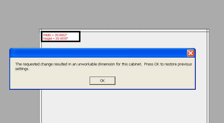

Can anyone tell me how to put an adj. shelf in this cabinet. I keep getting an error when I try to do it.

Yup it does it to me too Wally. My guess is it is because the shelf is being placed between 2 backs rather than sides

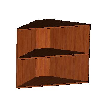

I added sides, then the shelf, then removed the sides. I don't know if it will work for you Wally. It does place in a room ok. HTH

Thanks Rick -- That worked.
