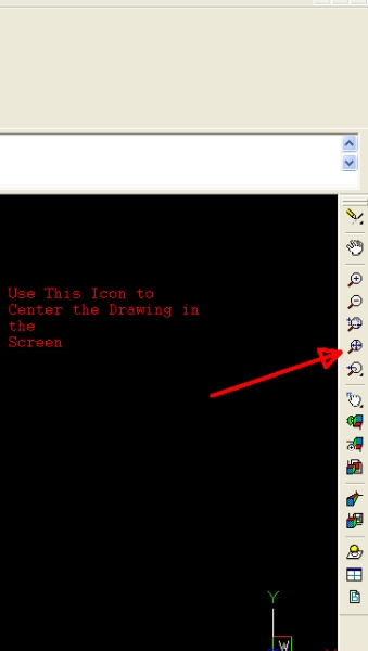

Gary,
After you open your .dwg file in Intellicad, click on the Extents Zoom Icon (see picture) The Zoom Icons are the magnifying glasses. Your tool bar may be horizontal on the top of your screen instead of vertical on the right . This will zoom the drawing to fill the screen. There are also tools in this tool bar to rotate the object.
