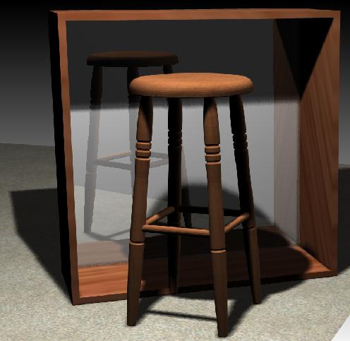

example
example

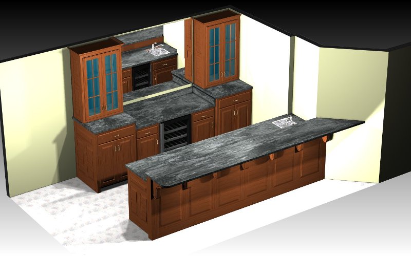

Here is how I do mirrors. I use a display cube 1/4" thick and the size I want for the mirror. Use the black melamine in my solid colors for the image. When you render this, set the shine for the display cube at 100%. Someone posted this tip a year or 2 ago, and it works very well.
HS Bar 3.jpg (60.21 KiB) Viewed 8007 times

That is a lot easier! Thanks Gene!
