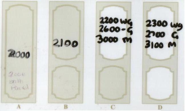

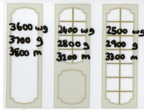

Hi,
I have spoken to the programmers regarding a fix for the Door/Drawer Editor, they said if they get enough feedback, this issue will be looked at. So if anyone else is facing this issue or something similar can you post a feedback comment.
Issue:
The doors which we design are not supported within eCabinet Door/Drawer Editor, i.e. we have double panel doors, some of which can have the top panel cut out and some can have both cut out. We can have more than one tool on the inside, sometimes can be 3. We can have arcs top and bottom or Left and Right on an inside route, and we also have a 4mm radius on the corners. These are the things which are not possible within the Door/Drawer Editor. (I have attached some of our designs to give you an idea)
As these things weren’t possible within the Door/Drawer Editor, I was instructed to use a back panel, which is fine. But I still have a couple of problems with some doors, but that is another matter. So I have all the doors created as back panels, this is fine until using them in the room layout area, this is simply because it is so time consuming and not accurate enough.
At the moment I am either adding my doors/drawers and pulls to a cabinet and saving as an assembly before I even enter the room layout area, which is time consuming and this is not how eCabinet is designed to work. This is also a problem as when the room layout has been created and a customer wishes to view the cabinet with a different door design, as I can’t do a global change as its made from a back, so I will have to repeat the process of deleting the panels and then adding the doors/ drawers and pulls in the layout area.
This is so tedious and doing a job could easily take several hours or more. The way I see eCabinets to work is to create your walls, input the cabinets and then add the doors. Then you have the ability to do a global change, adding the doors in the door/drawer editor is brilliant as it is so accurate. Doing it my way even if I was to do it when in the room layout area, is just not good enough as none of the handles will be in line some of the doors will be out and so on.
I know that what I’m asking for is a lot, and many people may not be having this problem. We are not actually processing our doors from eCabinets at the moment as it doesn’t have the abilities for us to do so, so we actually use another program for this. So for this moment in time and people who have the same problems they should have some sort of “Display Only” button within the Door/Drawer Editor, then you should be able to copy the created door from which is a back panel, which is HSF into the doors file in eCabinet. (This would be ideal as a short term fix) We could then use all the abilities of the Door/Drawer Editor which would make design time a lot faster, it would also make everything more accurate and much more user friendly.
(At the moment you can’t copy into the Door/Drawer file as it asked for the settings, such as width and so on, and will start creating a new door or drawer)
So if anybody else is facing this problem, send a comment through feedback. Sorry it is very long winded but it is hard to explain.

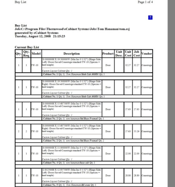

Gary, Your door list is easy, click the buy list button and viola, You have your door sizes. As for the MDF doors, I have found that you can make them but you have to do a little thinking outside the box. I have made mdf mullion doors and all kinds of raised panel doors with just ECab software. I will not say it is the easiest but it can be done and after you have learned what to do, the next time is much easier.
Good Luck.

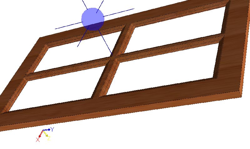

Here is a mullion door that I have cut several times Neville, This one was probably the trickiest one I have done todate. After cutting away so much material the hold down is not good. Block it in with some scrap to hold it in place.

Hi Damon,
Very impressed with the doors! How did you go about creating them, as you only have the ability to have one centre route tool.
If you take a look at my diagrams at the start of the post and look at doors F and G, do you think it is possible to do such doors?
How does it deal with a resize?
This is to me the most important thing that eCabinet needs improving on...

I don't see a problem making any of them. As far as resizing them, I would have to play around with that and see. As far as a square door it is no problem.

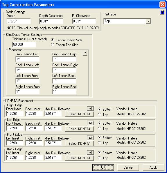

Hi Gary,
The file that I attached is a form of the KD Fastener construction. When you select construction you will choose KD. Then you will need to associate the new pattern to a piece of hardware. Once this is done, you can change the distance between each pattern and the distance from each edge to the first hole. Here are some pictures. Let me know if this makes sense. At some point we do plan on putting crystal reports into the software for customizing areas that use this but cannot tell you when as I don't know.
This shows the construction area where I used 64mm for the distance between and 32mm from the 1st hole to the edge.
This shows applying the dowel pattern to a cabinet.
