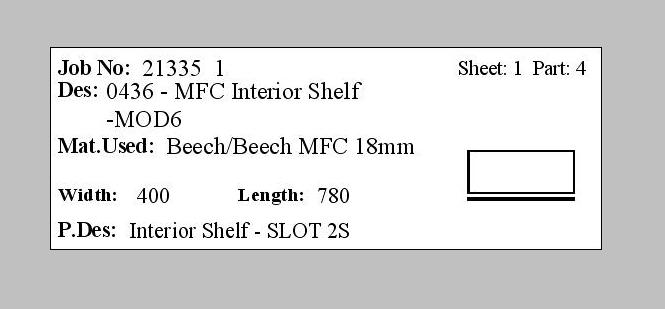

This is an image of how I have got our labels looking so far. The edge banding bit map is ok but it doesnt display enough detail, when exporting a cut list to Excel you can see that all the information for the edge banding is in "Sheet Component listing" under coloumn "F".
As you can see, this is the sort of detail that we need to display which is visible in Excel from the cut list:-
Back Banding: Montana Oak Front Banding: Montana Oak PVC Edge Left Banding: Montana Oak Right Banding: Montana Oak
This is with edge banding on all four sides, and this is the type of information that needs to pass to the shop floor.
The problem with the edge banding bit map is that people dont know what type of edge banding to apply, for exmple they dont know if it is to be a beech edge or a beech pvc edge. So this will be very confusing for the guys in the factory.
As I mentioned in my previous post, I wasnt able to input anything into the database and this information isnt currently there. So is there a way of getting this information into the database("result").
