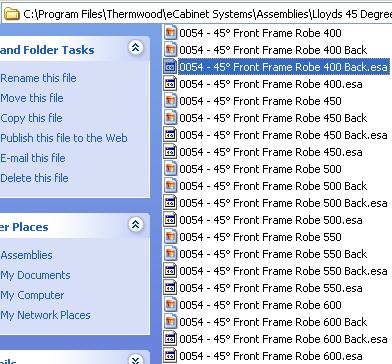

I am having a problem with the "Import Batch From Excel" this problem is only with the Assembly part of it. I seem to be getting an error everytime I try and Import from excel.
An example of one of my lines are:
Name = 0054 - 45° Front Frame Robe 400 Back
Directory = Lloyds 45 Degree
Type = Assembly
Qty = 1
If anyone is having the same problem or its just me can you let me know please.

It might be the degree sign in the file name. Try copying one of the files and give it a very simple name to see if that is the problem.

I have tried other files just in case it was the degree sign, but the problem seems to be because its an assembly. All the Cabinets work but none of the Assemblies will work for me.
