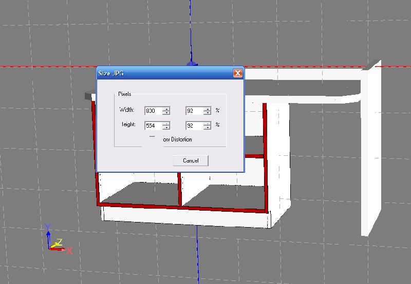

Has anyone else ever had this problem?
If so how do you keep is from doing this?

Chad could you explain in more detail
Re: problem with making jeps of cabinets
I believe that's a known issue Chad. If you use two monitors then just drag it away, if not then move it as far away from the cab as you can before clicking save. Anyone else?
It does it on mine too.

I have this issue as well.
If I need a jpg that is clean I will capture the screen using infraview feature then I will crop the image using my hp scanning software & resave.

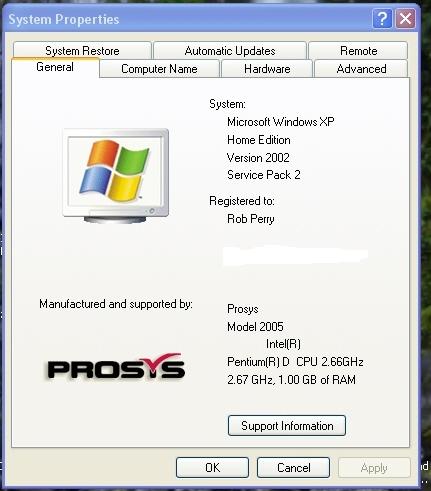

Chad, Rick and Rob:
What are your system specs, specifically RAM, CPU, video card, video RAM and operating system (including service packs if any)?
I am using a Dell Precision Workstation 380 with a Pentium D 3.4GGHz CPU, 2GB RAM, nVidia Qyadro FX540 with 128MB RAM. My operating system is XP Pro version 2002 with service pack 3.
I'm curious as to whether any of these have any effect on making the snapshot dialog box appear in the image. Like I said, I have never had this issue and that is on mutiple systems. I don't have the issue on my Dell Inspiron E1705 laptop running Vista Home Premium either.

This is my system
Vid card is nvidia GeForce 7300GS OC 256MB pci Express
Rob
