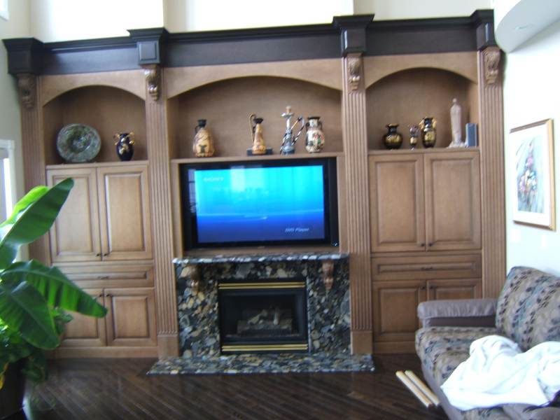

How about this for frameless -----

Nice Job,
What is the stone on the fireplace, and how did you attach the corbells to the stone?

It's called River rock granite and I drilled holes in it and attached the corbels from behind with long screws. Then the granite was installed.

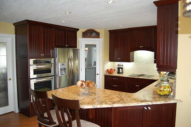

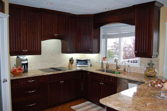

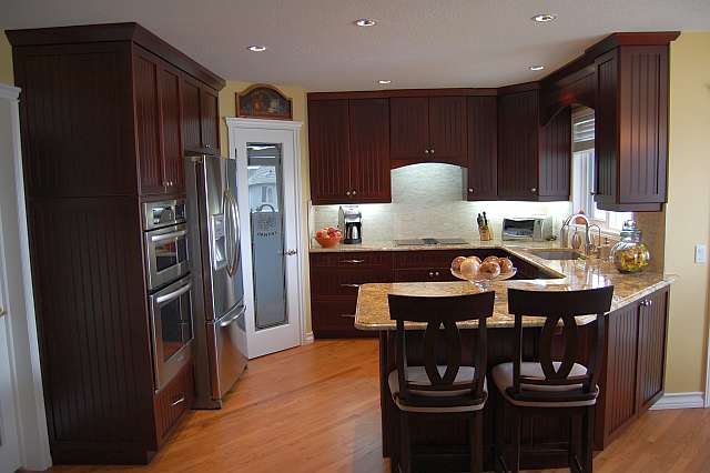

Here's another I just finished but it doesn't have corbels.

Very nice,
Do you do your own finishing or do get your doors pre finished?

Yes ... I do my own finishing. These are spray stained with ML Campbell Woodsong stains and then topcoated with lacquer.
