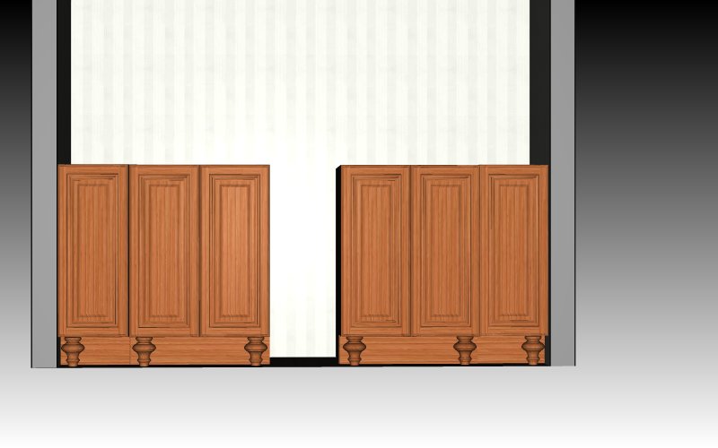

I have tried everything from a display board to a display panel the toe kick will not come out the same color as the foot and the door.
The box is made out of Melamine and the toe kick looks like the color of the Melamine. The cabinet editor will not let me match texture on the Melamine. It will let me match texture with the display board/panel. I can not associate the display board/panel to the cabinet it will not let me.
When the cabinet is in the cabinet editor eveything looks good, it's when I render the drawing this color happens.
Any ideas.
Mikes and Vicky Bathroom.jpg (45.24 KiB) Viewed 8672 times

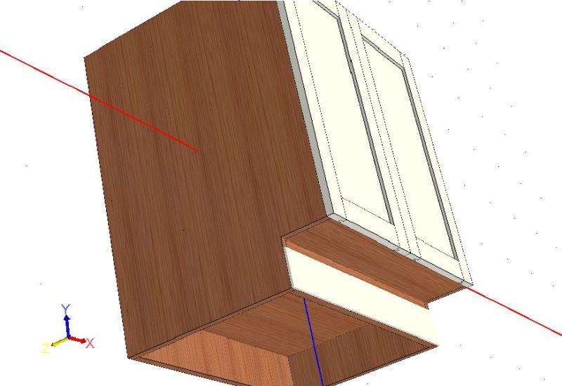

Mike bates 24 cabinet.jpg (42.11 KiB) Viewed 8516 times

Re: Toe Kick Problem
Post by Damon Nabors »
Gary,
You have your display panel embeded into your toe kick. You need to bring it forward 3/4" so that it is infront of the toekick. One question though, Why not make the cabinets in two sections rather than four. It would be less material involved and less weight. Just a thought.
Gary's jpeg.jpg (41.09 KiB) Viewed 8488 times
