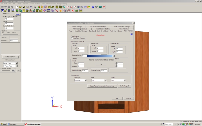

Has anyone run into this one. If I try unchecking "Display Finish Common With Door" I get this message.

I have never noticed it before :? but I looked at the face frame thickness and it was set at .71 and I changed it to .75 and it works ok now.

The message is from not having .71" material set up in your board stock. I noticed when I unchecked common with door and also changed the frame thickness, i get the same message. Notice that now the material name is blank. There is no material set to that size. If I add a material to my data base under that thickness, it will now show up and not give that message. I hope this helps.

Thanks Justin, not sure where the .71 came from. This was my seed cabinet that I normally use that has always been set at .75. :?
Maybe now the software is starting to help us make material choices :joker:
