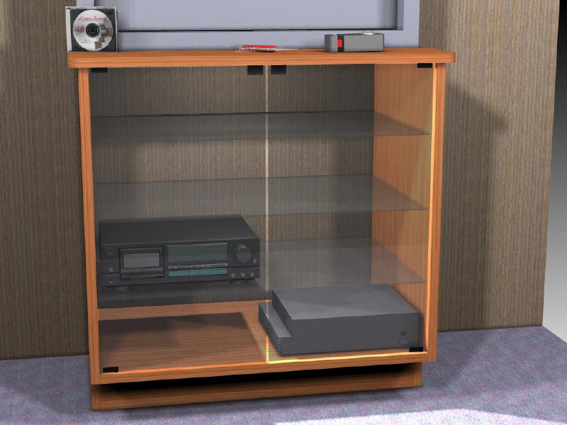

Is it possible to show a cabinet with glass shelves?
Also for the glass in the door.
Any thoughts

Like Rick said at is the best way
Stero Cab_235.JPG (62.37 KiB) Viewed 3733 times

I've had two files posted to the web as examples of the contents of "The Nearly Complete Guide to eCabinet Systems". Coincidentally, these documents describe how export a shelf and modify it in the Display Part Editor. It does not show how to install the resulting glass-like shelf in the cabinet, but it is a Display Object, so can be selected and installed as a Display Object. These parts must be asssociated to the cabinet otherwise they will not be saved.
To view the two examples, go to the Training tab on www.ecabinetsysems.com. Locate the image tile for the training guide. Double-click on the image. Then locate Excerpt 1 and Excerpt 2. These are the links. You can download and save these two files.
