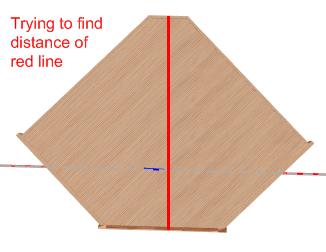

I'm trying to figure out how to make my corner cabinet have the proper depth from angled face frame front to angle from corner gap. Since I don't think I can possibly do it justice trying to describe it in text, I'm going to post a picture. My guess is that I'm going about it all wrong but I honestly don't know so here it is. Any help is always greatly appreciated!
P.S. The reason I need this is because the island counter top will also be angled in the back and I want to keep a consistent counter top depth at all points.

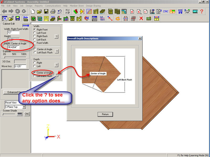

Re: Corner island cabinet
Center of angle is what you want...
Angle Settings.jpg (82.82 KiB) Viewed 3475 times
Post by Derek Krzanowski »
DOH! I looked at those options a thousand times and never clicked the "?". However, I did read the tool tips and they are identical for width and depth. This should get fixed for the next release if possible. The tool tip for the depth even says width so it must be a mistake. Anyway, thanks a million!
