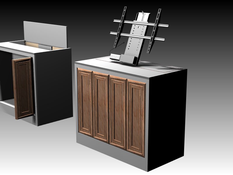

Here go Joe
It can be resized and top part can go up.
You will have to get some screw and nuts and bolts
TV Life.zip
(98.11 KiB) Downloaded 565 times
TV Lift 10-20-08.jpg (49.69 KiB) Viewed 6566 times

George, I've been "fooling around" with the WhisperRide" TV lift file, to "learn" to use the Display Part Editor.
I can resize the entire assembly, but is it possible to select the individual parts and resize them?
The assembly looks like it consists of 15 separate parts, but I can't separate or select them individually. Do I need to do that with the "original" image file ?
Any guidance you (or anyone else) can offer would be appreciated.
Joe
Re: Whisper Ride TV Lift
Hi Joe
If you take the STL Files back into the Display Part Edtor you can move that part up in there then save and rename it

George, for the WhisperRide lift I only have the HSF file. Where can I find the STL? Or can I convert the HSF back to an STL ?
Joe
Hi Joe just take the HSF in to the Display Part Edtor it will do the same thing.
It has 15 parts you can move around and change the colors
