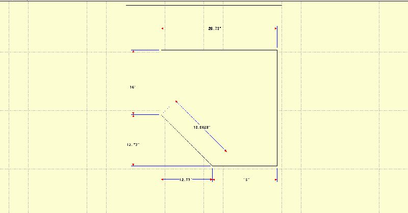

You mean something like this?
Std Upper Corner Frameless 16.hsf
(170.02 KiB) Downloaded 386 times
Std Upper Corner Frameless 16.jpg (11.26 KiB) Viewed 3711 times

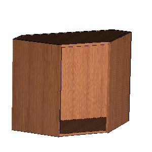

Well, you know that the front needs to be 18" and the sides are 16".
Remember that A square + B square = C square.
Take 18(C) * 18(C)= 324/2=162 The square root of 162 is 12.73". 12.73" plus 16" = 28.73" This is the length of the back.
Hope this helps.
Angled Back Formula.jpg (27.05 KiB) Viewed 3674 times
