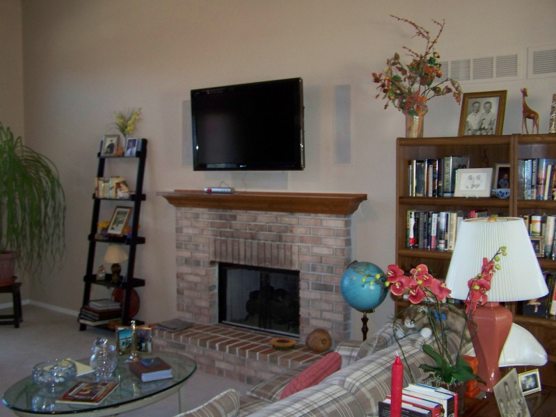

I have a project to do and can not come up with a design.
The flat screen needs to be closed in and two book cases with bottom cabinets one on each side. Now tie it all together :?
Any Ideas will be greatly appreciated.

Gary, you also need to be thinking about those air registers on the wall where the right-side bookcase top will go.
Maybe want to replace the mantle shelf with something that is deeper to match the bookcases and span between them. You could use multiple stepped crowns to get the depth. Then close in the TV on the "shelf".
I did one like that several years ago - if I can find the pics I'll scan & send to you. No TV but otherwise very similar situation.
Did the base cabs in MDF on the fireplace side to be safe - the stuff is so dense it wont burn unless it's in a furnace...
Had to cut back the L/R hearth brick overhang with a masonry blade on a grinder to get the cab's flush- VERY messy.
The mantle projection needs to be to code, usually - something like max. 3/4" projection for each 3/4" away from the top of the firebox, STARTING 12" above. Check your local inspector.

Thanks Joe,
This poject is for a very good clients mother and I don't think she wants to bump out the mantel ( that was my first thought)
but she does want to hide the TV. :wall: So far 3 days and no ideas. Thanks for the responce.

Another problem with trying to hide flat screen tv's is the fact that they are wider than they are deep so pocket doors are kind of ruled out.You can still put doors on there that swing open but then they are in the side view angle. Bifold doors helps some but will not eleminate the problem. Another thing you might consider would be some type of picture screen that would cover the tv when not in use.

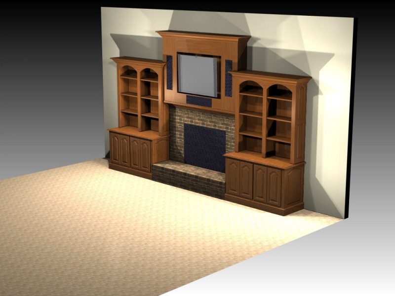

Well here is the first drawing

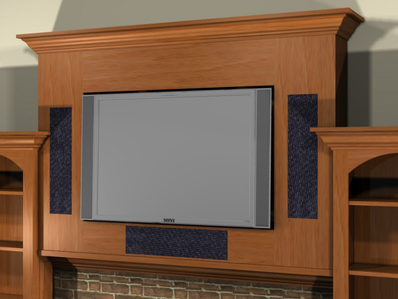

Here is a close up view of the mantel
