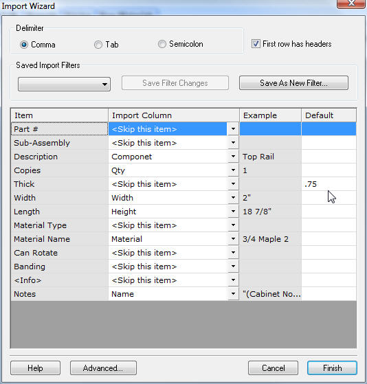

1) export ecab cutlist to excell
2) then go to the sheet good tab and save it as a cvs file ( you will have to do this again for the face frames)
You can only save the tab that is showing on the screen.Save them to your desk top
3) shut down ecab. then go to cutlist plus and import the cvs file (sheet goods) you will more than likely have to modify your material information. A import wizard sheet will appear, you have to click on each line and make the import column just like this one. When you get to the thick line in the default column you have to put .75.
