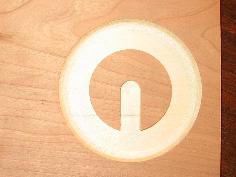

I'm having a bit of a problem cutting this pocket. I created a display panel and used part editor to draw a 2" circle. Selected cut pocket .25" deep and wrote the .twd file. Sent the file to the control and nested the part. Everything looks good so far. When I ran the part, the attached picture is the result. It's using a .5" diameter comp tool to cut the pocket. It goes to the center of the circle and cuts the straight segment to the perimeter, cuts the perimeter and then goes back to the center. I'm guessing that I have some setting incorrect in control nesting but my tests haven't changed a thing. I've cut through pockets like this before. Anyone like to turn the light bulb on for me?

It appears that cn sees this pocket as a drill operation.

Kinda makes sense if you think about it. What Control Nesting (CN) is actually seeing is a CIRCLULAR feature at a non-through depth - basically a blind drilling operation.
If you were to place a very,very small flat section in it (like a line 0.002" in length), it would no longer be a CIRCLE which triggers the DRILL OP, but might instead see it as a POCKET candidate. The tiny line introduced would not be noticeable.

Check your drilling tool operation settings. I'm guessing you have a max interpolate value set too high. This looks like an interpolation operation has been performed which obeys the max diameter setting.

Typically we will recommend that operators setup the Max Interpolate Dia. so that it is NO more than twice the cutter's dia. This way when the cutter makes the full circle cut, all material is removed and no plug will be left behind. Then, the Pocket Tool which is setup in the SETTINGS can be used to pickup pockets with geom. that needs to be cleaned out entirely, or leave a plug for those cuts that are a cut Thru, but meet the Min. area requirement that is setup.

You guys nailed it. For what ever reason, the max interpolate setting was more than twice the diameter of the tool. I double checked and made sure all tools are set to .001" less than twice the diameter of the tool. I ran another test and it worked perfectly. I must have been fooling around, I mean testing, and made that change sometime in the past.
