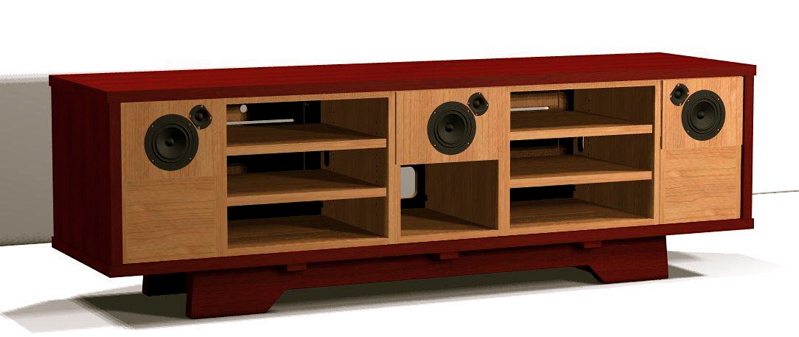

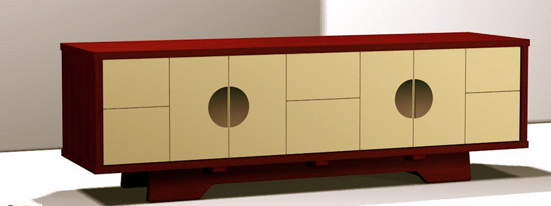

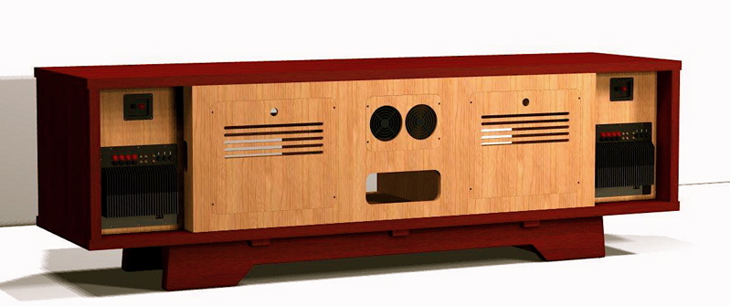

It's pretty amazing what you can do with eCab. Everything was designed in eCab. This is a prototype design of a A/V furniture unit with integral sound system that I would like to build some day. I really like the idea of no external speakers with wire and decor matching problems. Probably have high WAF (wife acceptance factor) rating :) It's designed as RTA and meant to have casters underneath to easily move unit away from wall and back for wiring/a/v component access. I had a audio engineer friend help me with speaker selection and sub port cab design. Basically you have left, center and right front channel speakers with two down firing subwoofers. Each of the subwoofers have their own individual amps. There is a double fan unit that would draw fresh air through the bottom vents and push out the back. Back panels are drilled for quick turn release connectors and have plentiful wire access. Door design needs work. Intent was to have wood case and solid color gloss lacquer fronts. The color of lacquer would be chosen to get a match with speaker cloth of the L,C,R speakers so everything blends together and the speakers don't punch out visually. Touch latch doors and touch latch tape/disc drawer under the center speaker. False fronts under L&R speakers because those are the subwoofer enclosures. Spent a considerable time laying out the design as per what's required to handle adequate a/v components and then drafting in eCab. :wall: Market probably slim for this type of furniture. Would still like to build it someday, at least just to hear how the quality of sound pans out.

Hay great cabinet. We make a lot of this style cabinet here in perth western australia, but usualy put speakers behind doors with speaker cloth panels. Please tell how you show actual speakers and equipment mounted into the cabinet in an ecabs image.

All the components (speakers, amps, speaker hook up posts and fan grilles) were sculpted from display cubes in the eCab parts editor. The speakers were the most difficult. Profile tools needed to be created in order to get the end result of the speaker design that was closest to the actual speaker drivers I wanted to use. A lot of trial and error but when I finally got the right tool and result, very satisfying :D I don't know how to use real CAD and am still amazed what can be accomplished with eCab.
