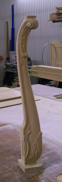

Some examples/ photos of legs you've done. I got some information back from our support guys tough. Now I have to just test all that myself.
Pictures would be greatly appreciated if you have any.

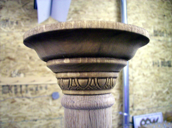

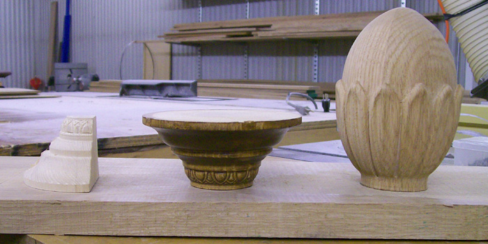

here goes. I got some picutres tonight. If I can get em posted here we're in buisness.
Ray Jorgensen
Posts: 199
Joined: Sat, Jul 29 2006, 9:11AM
Company Name: Classic Custom Wood
Location: NC Iowa
Re: Anyone out there with rotary playback on thier machine
Post by Ray Jorgensen »
I can't figure out how to do more than one at a time so here are some more.

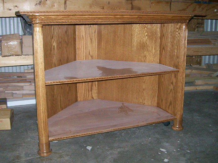

Sorry for the dust in the last one, should have gotten the rag out. Waiting for glass doors.
If I'm lucky this one is the column only.

Your pictures are great. I am assuming that you machined all of those on your Rotary Playback Unit (RPU). Did you program then yourself using Mastercam, ArtCAM or another product? Or were they products of pre-made programs rented through Thermwood's system?
We here at CNC Automation have supplied Georgi's company with a post processor for Mastercam that allows then to program parts that have "turned" elements and fluting, as well as any type of 3 axis machining in a positional mode. We have a couple of other companies that also use ArtCAM, including one that has an 8 spindle Model 80 rotary carver. We have run into reluctance on the part of some of our customers in distributing pictures of their work with other companies - possibly due to possible questions of competitive markets.
I would like to thank you for sharing your results here.
( Note to all: Both the Mastercam and ArtCAM post processors for the RPU are available through Thermwood Corporation. :D )

Thanks for the kind works.
The leg and pinnaple looking thing are from the rental program - the others are my own designs. All are cut on my 45 with the playback. I've cut some other rotory things from the rental program but don't have pictures.
When I built my little homemade machine a few years ago I started with a free gameing program and a script the a fella in Scotland figured out for extracting the code. I have half an idea what I'm doing with it so I've just stuck with it. I'm no professional programer by a long way.
I have also used Thermwoods custom programing service, which greatly reduces stress!!
The egg and dart profile has proved popular - the TV stand is the 3rd project I have used it on. That's nice cause it starts to make all the time spent producing it worthwhile.
I'm curious as to how the cost of producing a part on the rotary unit compares to purchasing a ready-made part, for example, the cabriole leg you pictured.
Damon Nabors
Posts: 923
Location: Marion, Ar.
Post by Damon Nabors »
Dan,
I can't speak for the RPU, but as for the regular non RPU stuff, you can spend a day on some of those carvings. If you were to charge by the hour, you would have a hard time collecting. I look at it like this, I have the router and there are times when the machine is just idle, so start carving and go do something else while it make shavings. You could probable only charge $10/$20 per hr for carvings, simply because of the time factor vs what the market will bring. If you can make it personalized with names and such, then you can charge a little more. It is great to have the flexability of being able to make your own carvings. The time factor in programming also cuts the profit margins way down also.
