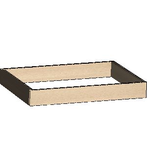

I am looking for a way to add toe kicks to a cabinet if I have a separate toe kick. Is it possible to make a toe kick that spans the entire run, install that item then install the cabinets on top of it? I will try but if someone could help I would appreciate it. This is basically for the layout view. Right now if I look at the cabinets they are floating on air.

Hey Don, here is an adjustable TK that I use. I install it at 0", then install the base cabs at 4".
TK.hsf
(114.02 KiB) Downloaded 378 times

In the eCabinets Stadard Cabinets there is the Std. Detached Toe.
You can modify this any way you want to use it.
