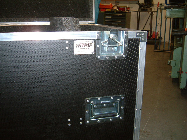

I have this issue as well.
See attached picture
1)The handle is treated as a pocket cut by CN and is spiralled out gradually as it should be , however :
2)CN treats the latch cutout as a U-shape incorporated in the panel outline . All very well until the panel nested alongside is also outlined , and then an instant hockey puck is created.
[img]
[/img]
Yes I could nest with collars but the thin collar strips can move as well. Yes I could double-pass but then I'd be leaving a hard laminate skin on just about everything I cut. It would be nice if CN spotted potential nest-created pucks and routed them out as suggested by Leigh .
I know CN can't be all things to all people but it's a little odd to be able to eliminate pucks in your parts, whilst, at the same time, the machine is creating its own pucks in the nest .

Matt,
I share your aversion to hockey pucks.
I don't know how complex the other machining is on that part, or if it's a standing production part that might we worth investing this effort, but here are a few thoughts.
If the part were a DXF file, you could draw and machine the pocket (turning it to dust), then cut the outline. DXF files allow the pocket to extend past the part perimeter, don't extend it too far or it will get cut into adjacent parts.
If you're always resizing the case, then you might consider leaving it in eCabs. Cut the latch pocket within the boundry of the part by say .004" and manually file off the nib left behind by the radius of the pocket tool.
Dave
