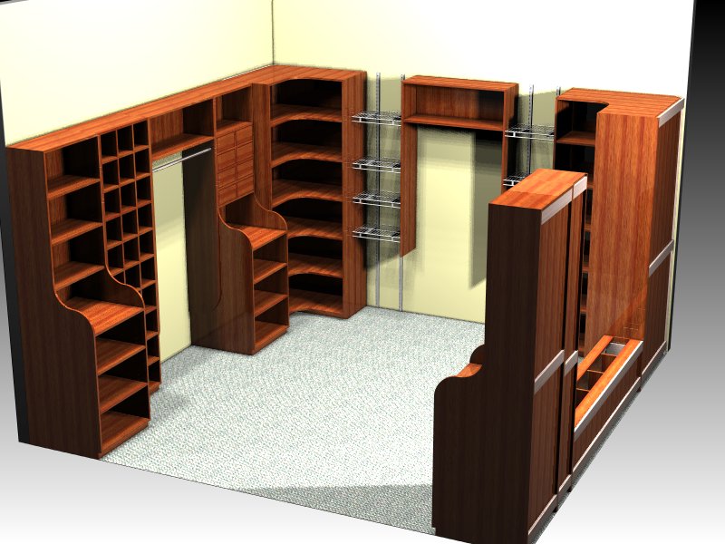

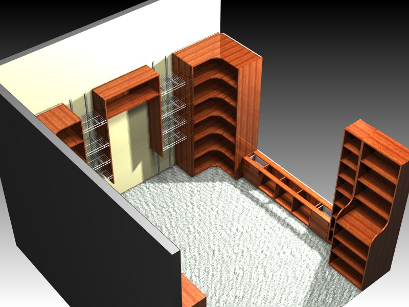

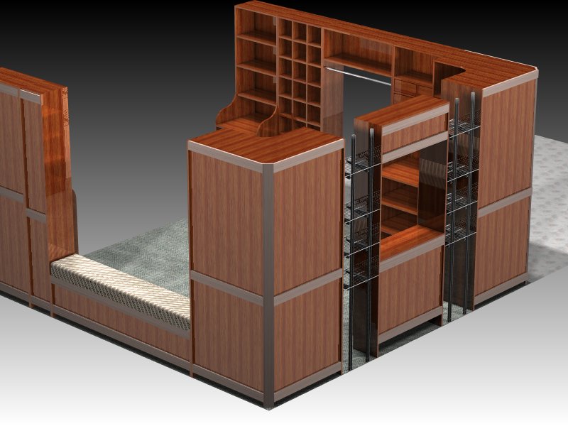

Master closet for a customer I know he will change it around
1-1-09 Closet_3.jpg (108.28 KiB) Viewed 56317 times
1-1-09 Closet_2.jpg (88.95 KiB) Viewed 56318 times
1-1-09 Closet.jpg (88.87 KiB) Viewed 56318 times

Nice looking closet George. How's the bathroom coming? :)

Nice looking closet George,
I like the curves.

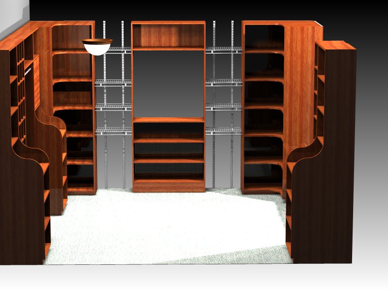

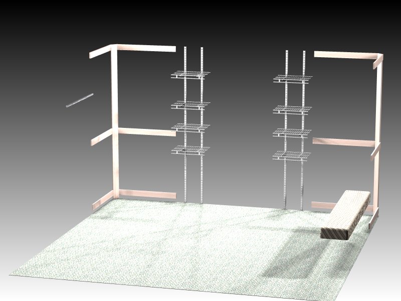

I was thing of putting the closets in the room so they could see it in the room That way I could put lights in the ceiling
and the attic steps in it

Very nice work in eCabs for this closet, especially the curved shelving. Nice. The customer can see exactly what he gets.
However, I was able to see it by accident. This forum section is for 3D images of items we might like to place in our room layouts such as plasma TV's etc. The place for this great closet is in "Customer images" sections where everyone looking for job examples can see it. I was just cruising for any 3D images I would find useful and came across your closet work.

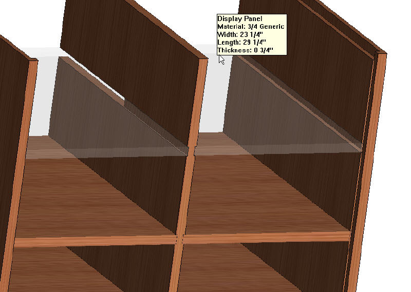

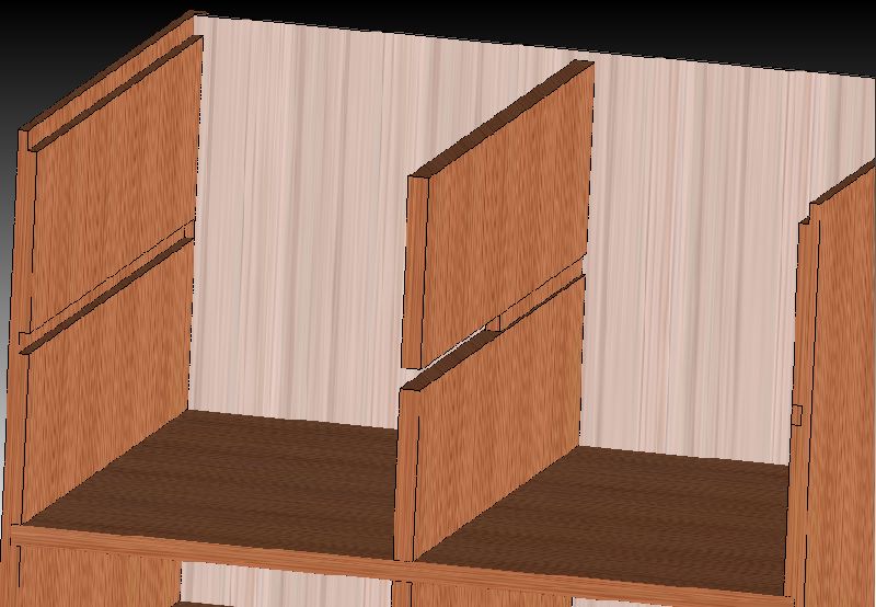

Hey George,

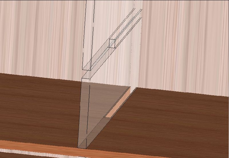

Nice closet. On your shoe cubby how did you do that one? are they just fixed shelves with partitions? I am trying to get Ecabinets to have the ability to do slide joints. You know the kind that you find in the box that has a dozen glasses in it with cardboard strips separating them. This would be ideal for these assemblies, wine racks and other storage racks.
Thanks for sharing,
Michael Kowalczyk, GM

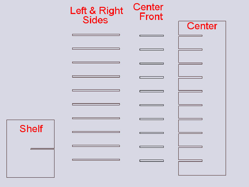

Re: Closet
They are just fixed shelves with Fixed partitions
Here is one I just was playing around with for you.
It took me about an 1 Hr
For me it's all in the DXF Files

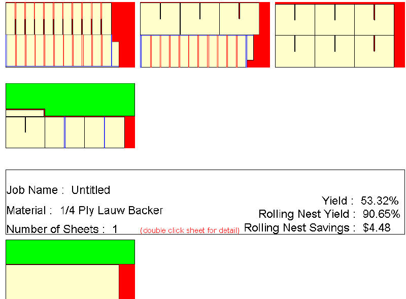

Here is the DXF's and Nest

Hey George,
Thanks or taking the time to draw this up but your own words ("It took me about an 1 Hr") are what I am trying to get this operation added as a parametric feature. Would it be better if it was only a few clicks? :D If you change any part of the cubby, you have to redo a dxf, then go into the PE and so on. If you change your material, same thing. There are so many other uses for this type of joint. I hope it makes it into V6 or V6.1

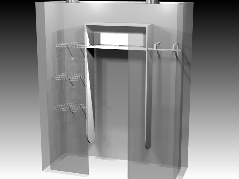

I have done a search for clothes on a coat hanger but no hits. I was wondering if anyone had done something in this area? I was hoping for shirts and long coat items so the space for half, 3/4 and full hanging can be highlighted.
Neville
Neville Australia
JohnLashuay
Posts: 645
Re: Closet
Post by JohnLashuay »
Neville Bastian wrote:Hi Everyone
Neville
Here is a jacket and t-shirt that someone else created, I just added the hanger.
Also here is a dress that is pretty rough.
-John

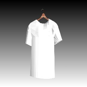

Here is the T-shirt
mens t-shirt on hanger.jpg (6.25 KiB) Viewed 55850 times
