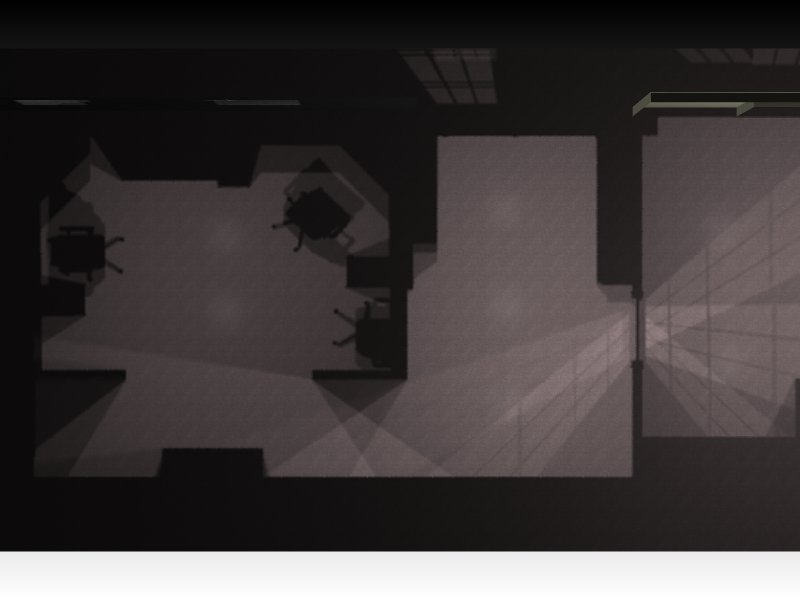

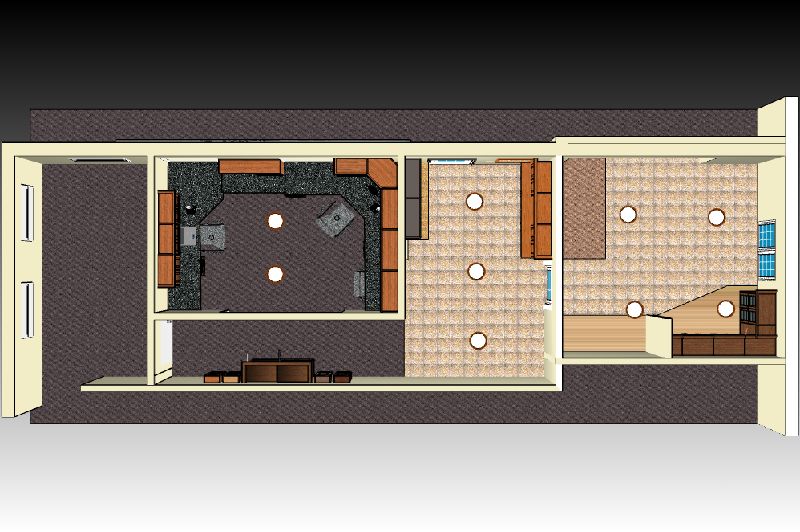

Here are two jpg's of the office that I am having problems with. One is just rendered and the other is in presentation view.

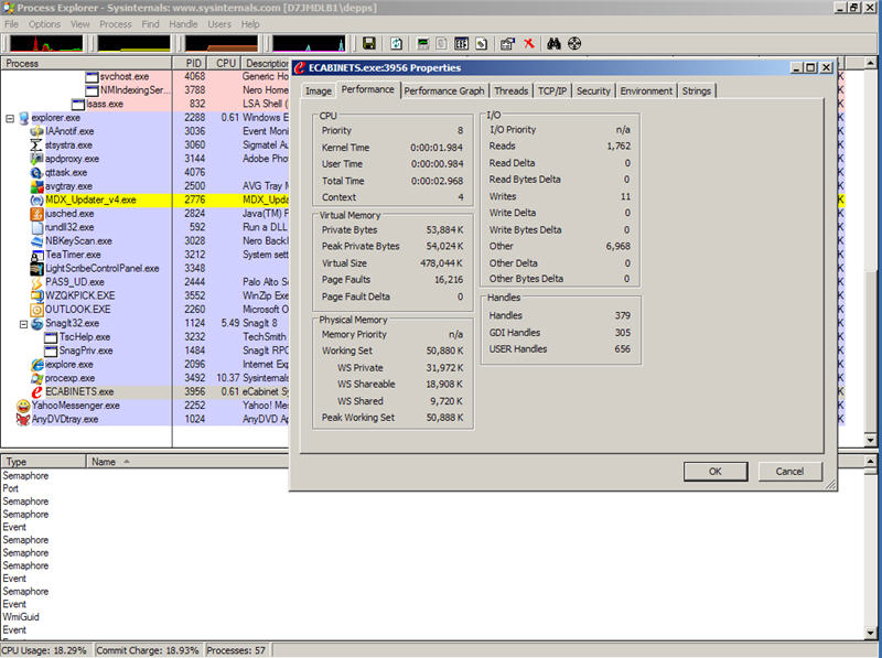

Dan is there a way to gauge how much memory is being used?

JohnLashuay wrote:Dan is there a way to gauge how much memory is being used?
Microsoft has a suite of tools that let you see just about everything that's going on in your system. Originally developed by a third party, the Sysinternals suite was purchased by Microsoft a couple of years ago.
Go to Sysinternals Suite and download the entire suite. Then use the Process Explorer to see exactly what resources are being used by any running process.
In the attached image you can see the process information dialog that is displayed when you double-click a process (in this case I double-clicked the eCabinets process).
Most of the tools are targeted toward developers and are not much use to users, so read, understand and follow the directions for each utility before using it. Some can perform destructive actions to your registry!!! Process Explorer doesn't do anything to the registry so it is safe to use.
Process Explorer.jpg (92.36 KiB) Viewed 10585 times
